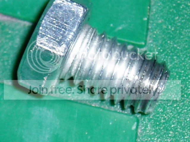

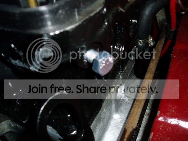

Check this pic. 5/16, standard threads; 1/2 length. Gets in about
three threads, without really torquing down on it:
And here is a pic of the bolt. There is evidence of black POR paint that
evidently encroached the threads. Gets about three threads, then really
tightens up:

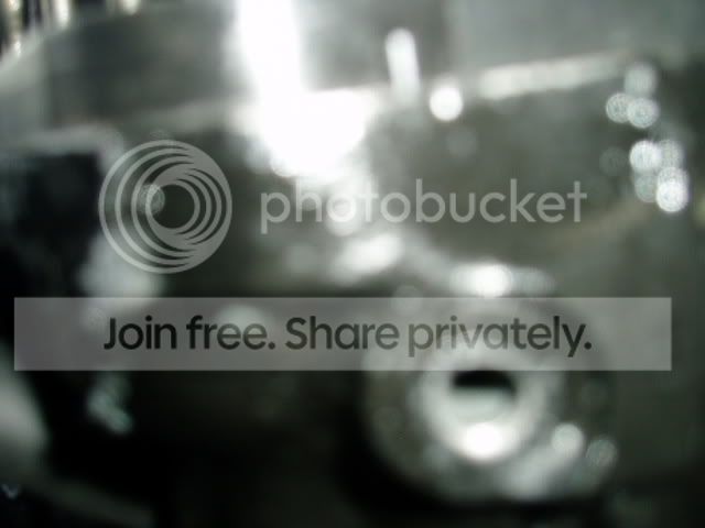

and now I will post a bad pic of the thread hole just cause I have it.
Sorry, it's in kind of a tight spot:

Certainly appears that the threads are just full of POR-15, which means you should probably run a tap in to clean them up. Smear some grease in the flutes first, to catch as much of the swarf as possible. Then every couple of turns, remove the tap, wipe off the contaminated grease and apply some more. When you are done, squirt a little carb cleaner into the hole to dissolve the grease, then run the engine for a few seconds with the bolt still out, so the oil will flush away anything left behind.
If you are worred that the threads aren't right, one trick I've used where it's hard to see is to sand down a wooden dowel (5/16" in this case) until it can be screwed into the hole with vise grips. Unscrew it, and hold a thread gauge to the marks left by the threads to check the thread pitch.
But from the looks of that bolt, I'm confident those are the right threads.

Those threads look course to me, or is it just the photo. Recheck them with a gauge.
