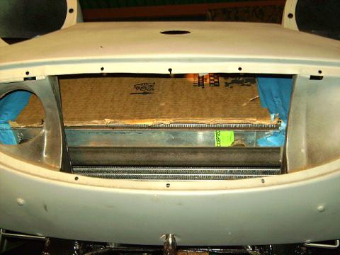

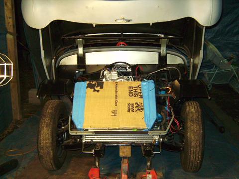

Well I actually got the hood on tonight, I had to drop the RAD another 5* and offset it to the passenger side a few inches to get the Rad cap to clear. I may have to go to a pancake fan as well, but will try and shoehorn the existing HD in fan first as it provides more CFM's than the pancake. I'll post a pic of the final stack up once I complete piping it all up.
Ok here's the rad with the hood on, it was as difficult as I thought but she in there with room to spare! Here the Rad, covered for protection from weld spatter with the hood up!

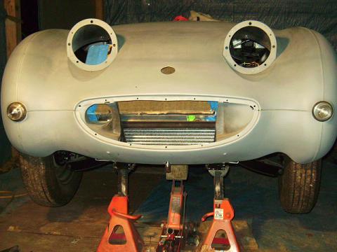

Here's the hood closed!

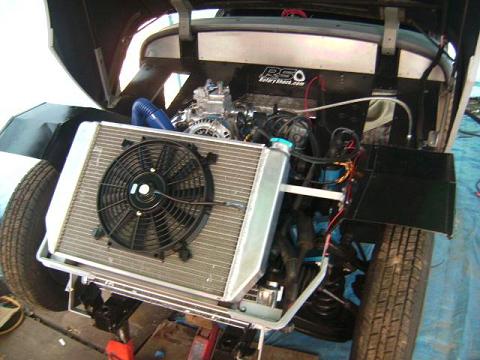

Here's a shot of where the 3500CFM 12" pusher E-fan will go!

Here's the final cool'n set-up!

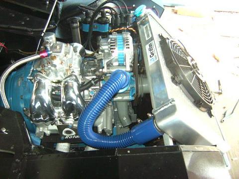

Another view!

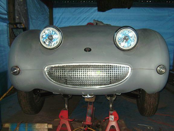

Cheese
Baby Blue Eyes - nice
Thanks, halogens too so there functional as well as pretty!
