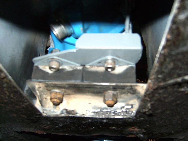

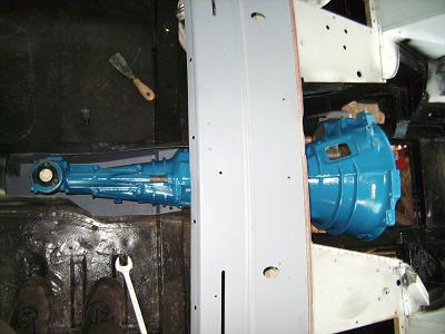

Ed I have photos of the whole build, send me your e-mail and what pics you think you need and I send them. The major Headaches were intake clearance, motor/oil pan clearance (I want to keep motor low so I jammed between frame rails), Lower oil pan motor mount, Tranny clearance, Tranny mounts and bed plate. I made the header and it actually fit nicely. Also made a heat shield between exhaust and intake. Like you I'm still working on the brakes, but at 1300lbs a rock on a string might work.
