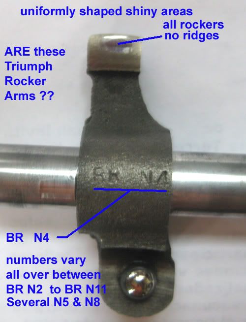

I've been thinking about something. Many parts on my car had been
replaced with Japanese car parts from the auto junkyard. Is it possible
my rocker arms are from a Japanese wrecked car? The arms have numbers
stamped BR N6, BR N4, etc. NOT in order and no BR N1 or BR N12,
several BR N8s and BR N5s. Are these the real deal Triumph rocker arms?
Thanks as always,
dale (Tinster)
edit-typo
Those look to be decidedly Triumph rockers. Besides, can't imagine a Japanese rocker being proper shaft I.D. and lengths along with correct pushrod ball diameters.
With a new shaft you'll have another 50K miles to go before you revisit this issue, likely more.
