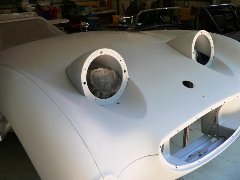

Bonnet is now at the paint shop. Sean is starting to finish the final body work. He is welding up any pin holes and completing stitch welds.
Additional dolly work.

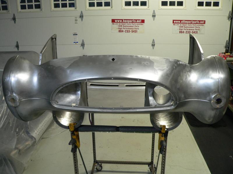

Rebuild or build up the headlight bucket weep hole.
Not many pristine bonnets on the East Coast to choose from. I think in the end it will be worth the effort. When I picked it out
it looked very solid. It was solid but beat to death. Lower corners had to be rebuilt and the front valance replaced. You will never know what you have until you strip it. You can buy a car and think you have a winner, many times you are just buying someone else's problems.
I know in the end what I have and how it was repaired. Lots of effort but worth it in the end.
First Round of Filler
Notice the body work on the tops of both wheel arches because of stress cracks. I put a rolled angle inside of both arches to strengthen them.

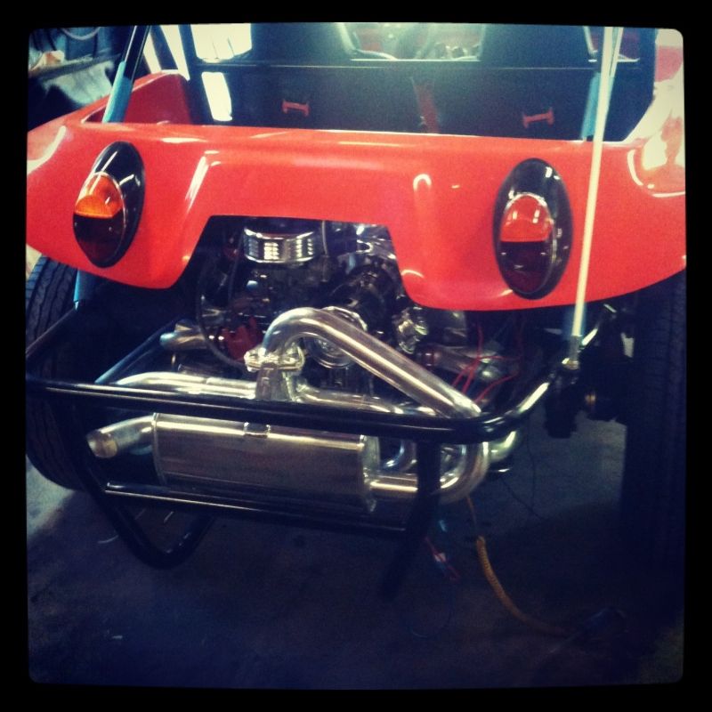

I built a Berrien Dune Buggy with an Orange gel coat. It is a Manx clone. It has a tube chassis with a fiberglass pan that looks like a stock floor. I have a complete build on it as well on the SAMBA website. The motor is a stock 1600 with a single carb. It is slow but reliable. I have a Tri Mil jet coated exhaust that is fairly quiet. I really love my DB. My grown kids even enjoy it and the grand-kids think it is a toy.
When I am at a car show it is always popular with everyone but the street rod guys. (Most of them bought what they drive so I don't know why they look down on it. LOL)
This is my photo site for the Berrien Dune Buggy.
https://s83.photobucket.com/user/hcallaway/library/berrien dune buggy
It is as close as I will ever come to building and designing my own car. I hope you like the pictures if you check it out.

I actually took the new grille to the body shop for a trial fit. Pretty good fit especially on the top. I never knew the opening was called the orbit. Nice to know. Your body looks like an Aluminum 427 AC Cobra. If mine can be a 4 on a scale next to your car I would be happy. As always great suggestions.
Have you fitted the grille? They are suppose to fit snug around outside and inside of the orbit. I enlarged my holes a little after re-chroming to get a perfect fit. Let you grille be your guide, it will show you if you need to work the metal more. Looking great!!

2nd Round of mud. High spots and low spots located. Trouble areas are known.
Let the fun begin.
It will be primed by the weekend and I will get it back in the shop to fit the bonnet to the body. Final fabrication will be completed. Then the body and bonnet back to the paint shop for blocking and paint.
Looking Great! I agree, fit bonnet to the hinges as well. Install the pegs so that you know that you have everything right, don't forget the rubber seal and your wing braces on too. Fitting the bonnets are such a pain.. I filled the problem areas with lead then skim coated to a smooth finish after I epoxied sealed the bonnet. I like to let the filler set up for several months after the last filler coat is sanded before the build primer goes on so the scratches can settle down before priming. I then give is a very light 220 cut, clean with Transtar and start the build priming. My final cut was 600 before the paint was sprayed.
Third round. There is very little filler left when it is blocked. Just getting out the highs and lows.
4th Round of Body Work on the Bonnet.
I am still along way from paint. The Bonnet is close to prime to start covering the small imperfections. Once that is done and sanded then it will be covered with a glaze. Then it should be ready for paint. I have some work to do to the bonnet so we will wait before we go to building up the primer for sanding.
