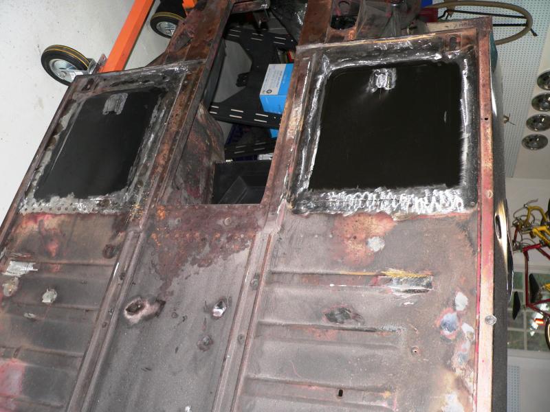

The only real fab work left is on the pedal assembly area. A few small spots now that I have flipped the car back up and onto the rotisserie.

You will find by not having the drop floors for your heels to rest on will cause driver fatigue!! I cut mine out and section new OEM floor pans to get them back!!
What I discovered is that the foot is not at the correct height when the floor is flat. The effort was cumbersome for smooth pedal function! If your fabricating them I would say about 2" drop at the lowest point which is about 3" angled from the firewall.

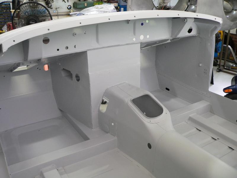

Being that you've boxed in the leaf spring mounts, you must be planing to run coil-overs? Are you going to use a different fuel tank, I only see three studs?
I think I faked you out with the angle of the shot. I am going to convert to tube shocks on the rear. As far as the fuel tank, I am planning on using an original tank. The other missing studs have holes for bolting it already drilled. You have much better eyes and attention to detail than me. Your build is phenomenal. You can see a gloss on some of the inter fender well. I am painting areas that the body shop might not get good paint in some of the tighter spots. I am not worried about overspray on those areas.

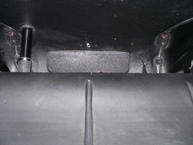

I worked on the inside of the boot area. It was blasted, sanded, primed and painted. Paint is still drying and I have to finish painting some areas with a spray. I left it bare where the painter will blend in the interior of the BE. I am leaving the excess body filler on the hole that filled. It makes it much easier to locate and drill from the inside after the body work is finished.
When I do cars, there are areas that I redo several times. Engine compartments, underneath the floor pan, floor pans etc... It is always easier to go back after painting and touch areas back up.
Yep you sure did have me fake off, lol! I painted the center of my boot with bed liner to deaden the sound, painted the rear wings and boot floor the color of car. All I remember of that job was how tight it was crawling in their taping and applying the material, not very fun!! Looking good!!
Those are the details that are worth the effort. I was looking at the largest seller of Bugeyes and some of the pictures show color changes. Both in the boots and engine compartments. His big $ cars are done right but some of his flips cut corners.
