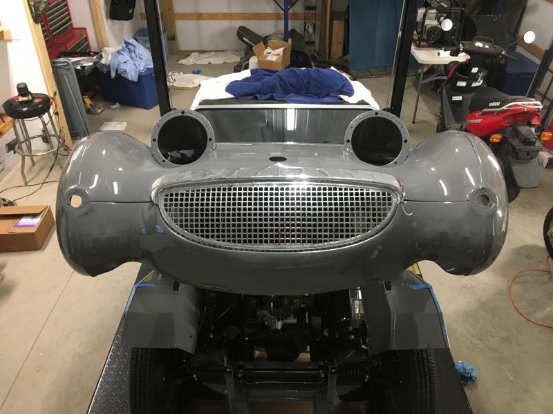

Bonnet Hood Stays
With the new hood stays I could not get the bonnet to close completely. The issue was the new stays top holes were not drilled out to allow the stay bolts shafts to bolt up flush with the bonnet.

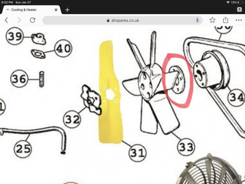

Fan blade for a 1275 is a tight fit for timing chain cover with the PVC canister. I made a spacer and added an extra washer for the fan blades to rotate without rubbing. Now I have a small issue with the old style vertical radiator.
9b48fb28-ddb3-43ac-895e-ae822d1f423e
There was a spacer required from the factory. I think it’s about 1/4 inch thick. DA942DED-CA71-4D07-BAC9-96B0D8A74420.jpg
