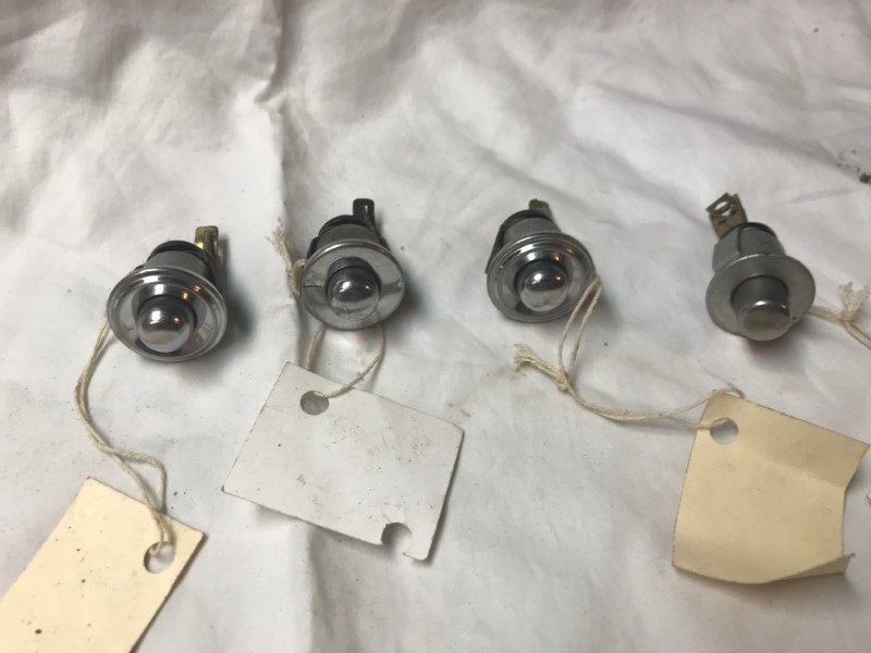

Light switch interfered with the Ignition Switch so I had to drill an additional hole. The remaining hole will now become my horn button. The search is on for one I like.
I have 4 switches. 1 and 3 have the same shape as your ignition key - 4 has the patina of your ignition key. If you want, pick one and PM me your address - no charge.
Don’t you have a horn button that fits that steering wheel. That size opening could fit a Moto Lita center push. Easier to use the needing to hunt for a push button located in the dash. Safety Fast!!!
