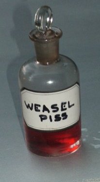

Posted this in the Restoration forum a while ago:
I have to post this here too...because I like it so much! :laugh:
Yessir...Weasel-Pee, brought to you by our friends at Rust-eze:
Rust-eze Van: Winter is a grand old time.
Rust-eze Car: Of this there are no ifs or buts.
Rust-eze Van: But remember, for all that salt and grime...
Rust-eze Car: Weasel-Pee can un-rust your bolts and un-freeze your...
Now available at Pep-Boys, AutoZone and Luigi's Cassa Della Tires
