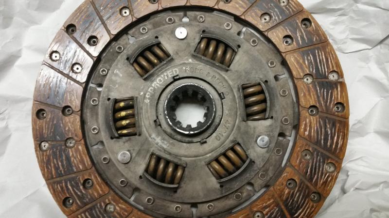

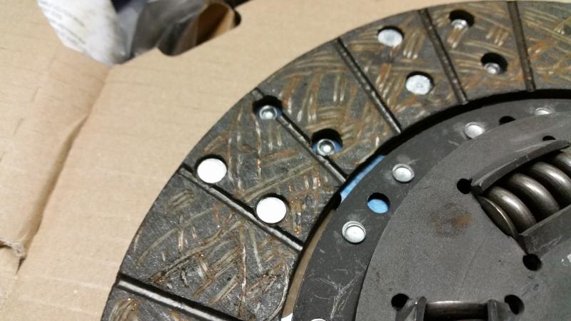

gonzo
Here are a couple of pics of clutches: one pulled from car with 20K and 20 years on it and the new replacement one. The new clutch has thinner clutch material than the old one. Why is that? Is this typical of new clutches from our suppliers? GONZO

Keoke
View attachment 49905View attachment 49904
This is typical today in most of our consumer products it is used to control their product price.
Usually involves a smal price increase but there is less in the pkg, thus preserving their bottom line.
The new style disk you show will work fine.

gonzo
Rattle noise likely due to worn Pilot Bush, so that'll be replaced but the original clutch parts are going back in since they're still serviceable. Is this "false economy" or should the new parts - which are representative of what's now available from profit-driven manufacturers - be installed? Oh, re-read Keoke message, new parts will be installed, but I'll keep the old ones. GONZO.
