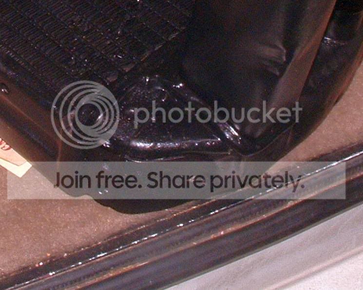

FWIW, I also had them reinforce where the extension meets the main tank. I've always had trouble with that joint cracking and leaking (partly no doubt because I don't support the extension while removing a hot radiator cap). They laid a length of 1/8" soft copper "refrigeration" tubing into the joint and soldered it to both the tank and extension. Although I've not had trouble with the upper hose fitting, I had them do it as well, just as extra insurance. Seems to be working so far. The repair is almost unnoticeable, unless you look closely.

Thanks for the feedback. Good suggestions for reinforcements too. Cheers, Mike

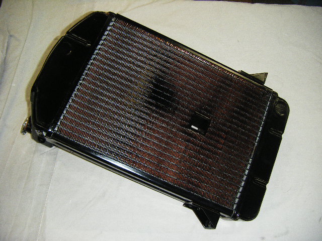

From the photo, it appears that they even reproduced the horizontal fins instead of the zig-zag fins used on modern radiators. The copper color inside the fins also makes it appear that the fins, at least, are copper/brass. Not likely IMO that they would go to all that effort to reproduce the original, and use aluminum for the tanks. But of course that still doesn't prove anything.

Got a prompt email reply from Empire British Car with no answer as to materials but rather that the radiators are out of stock at present. Tom

It looks to be the same that Moss sells . Its a good part and made like the original . I had no issues as far as fitting or performance and ran one in my TR3 with no problems . $375 is a good price , right around Moss' wholesale.
