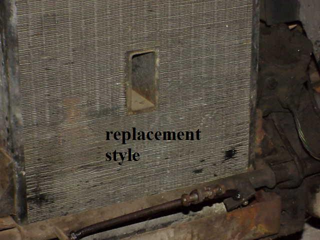

I don't imagine it was original but my parts car had a rad with a rectangular hole in the rad for the starter (longer in the vertical dimension but the same width as the original. I figure that was to get around having to shim anything. Given the hole is blocking vertical channels it would not change the cooling any. That rad is long gone.

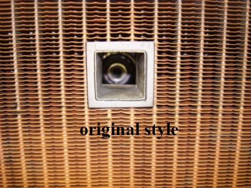

buongiorno Adrio
When I found by 3A in 1986, it had been hit in the front and the original radiator was replaced with a replacement unit from Triumph. See below this one had a rectangular opening for the crank. My understanding is that this size/shape hole was used so that replacement radiators were compatible with both current (TR4) and earlier (TR3A)units. For the restoration, we found a good used original radiator and had it refurbished.
