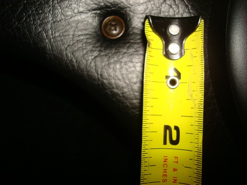

The area on the one kidney pad where the center support goes is destroyed. Can someone give me measurements on where the center hole is for this?
Thanks, Kevin
mallard
It's 110 degrees in the garage right now so this is the best I can give you. 9 3/34" from the back and 7/8" from the bottom. I don't think it's to critical to get it exact, this should be close enough.

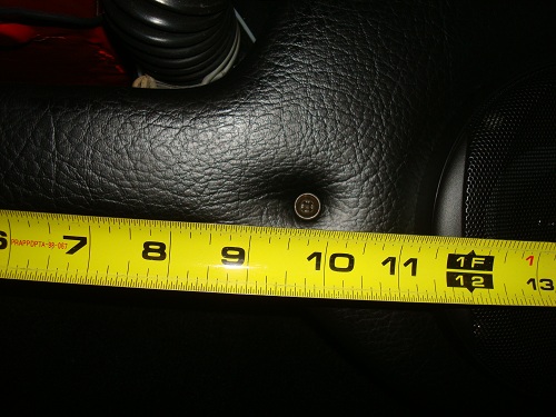

mallard
Next I got the second measurement if you would place the tape in the center of the screw and measure down.
