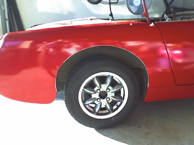

Somebody wants some bigger tires I can tell! With the Bugeye Bonnet going on I'm tempted to do the same.
64rocksprite
64rocksprite
Jim,
You got it!! My 175's just would not fit. I tried everyone's suggestions of 'rolling' the lip..still not enough room.
I like how the pass side came out.
Is it a <span style="font-weight: bold">perfect</span> circle? Naw..but I think it looks OK.
Everything I read on others making this mod was "used a pen on a string..and cut it out"
Seemed they were going really high into the body..not sure I liked how high other folks were going.
I tried to match the front the best I could, measured up from the bottom of the rocker.
It took me 4 tries of picking up the sawzall..then setting it down, thinking "do I really want to do this?"..Then I just said "GO". That first slice of the balde into her...that was scary
Gotta say..I really like the look with both wheel wells being round.
Now...I just have to re-produce this on the Driver side!!

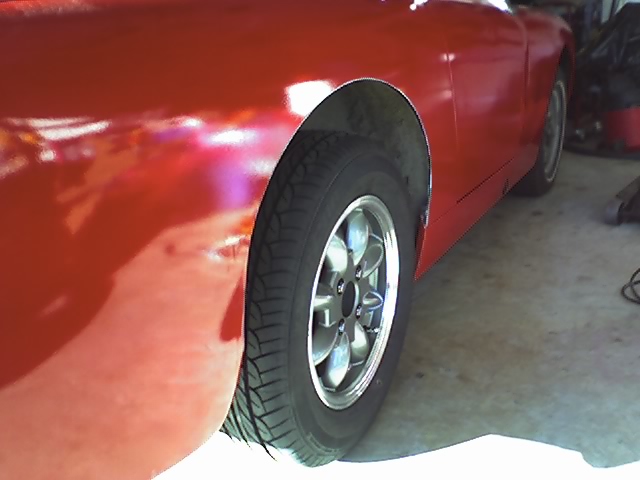

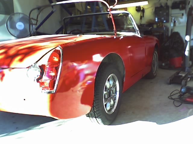

OK..finally, my phone is the only thing that takes pics small enough to load..
I wish I could send the others. I had one of the whole car outside..so you could see both wheel wells..maybe I can work on shrinking that one.
See what you think.

Man, those wheel arches are HUGE!
drooartz
Looks like good work. You're a brave soul to start cutting your car like that.
