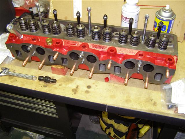

anyone know what size thread for a plug to go into where the egr used to be? this is for a 74 tr6 head, thanks guys! apparently hardware stores no longer carry hardware......or auto parts stores either.......go figure
Randy
YYCDave
From my PO who did the same thing, this from an old post of his "... the EGR port in the cyl head takes a 3/4-UNF thread (so it's not a pipe thread). I used a set screw of that size. That's one of those screws/bolts which has no shouldered head but rather a recessed Allen wrench fitting. Makes for a cleaner looking install. I had no trouble getting this set screw from a local fastener shop (look up fasteners in the yellow pages, and bring the EGR valve jam nut along if possible to positively match the thread). I was able to install it on my car so that the top of the set screw is flush with the cyl head surface..."

I got mine here in RI at Lowes hardware section in the fastener isle.
EDIT: Not a set screw, but it works fine.

Randy, I think that's it. I took the EGR with me and matched it up.
