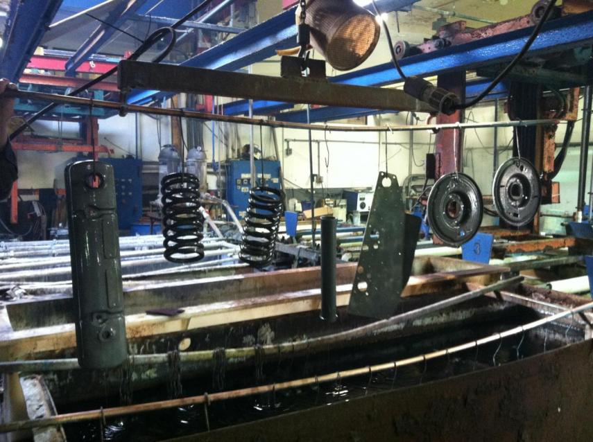

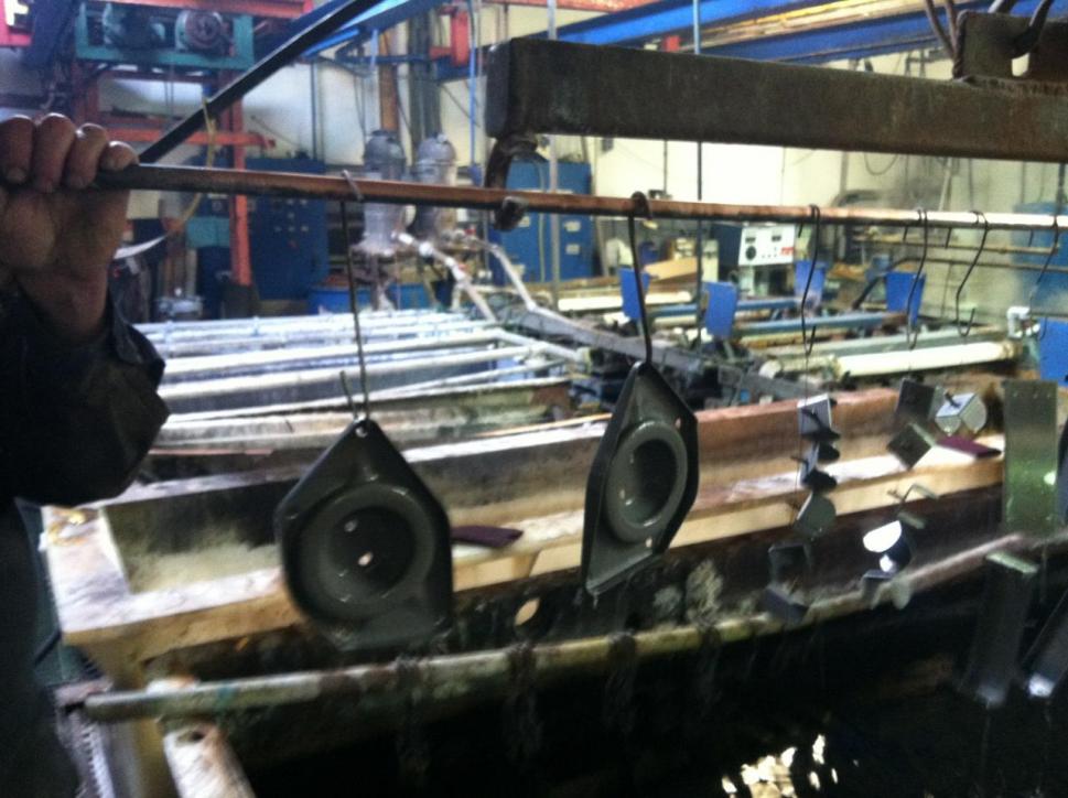

Well I'm no expert but here is my understanding.
The acids used in preparing metal for plating contain free hydrogen atoms which are small enough to enter the metal through miniscule voids and this makes it susceptible to cracking. HE isn't a concern for regular steel but anything hardened like springs, spring washers and high strength bolts can fracture without warning at any time after coming into contact with the solution.
The HE process can be reversed by baking at 200degC for several hours immediately after plating and is a mandatory practice here for any zinc plated automotive part, regardless of the hardness. Despite this, I got a fair number of spring washers returned from the platers snapped in half which is likely due to HE.
HE also affects welds where the metal around the weld becomes hardened from the heat and this is why over here it is illegal to chrome plate factory steel rims unless they are cut apart first.

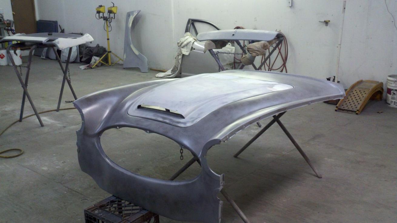

Here are a few pics of the parts at my friends shop. We went over the parts with usc icing glaze and then sprayed them all with a 2k high build primer and then hit them with a black guide coat. As soon as I get the last pieces sprayed then the block sanding will begin, 400 grit first then 800.
The winter has set me back quite a bit but my goal is to get the healey back on the rotisserie in april and start the chasis repairs. The floors need to go and i have to fight to get the last parts off (rear leaf springs, pedal box and door hinges) then i can media blast everything and start to cut and weld. I also have been out of town so I need to get my last couple body parts sprayed with the high build primer. Let me know if anyone in the area can come down this spring and offer some advice, lunch and beers on me!
