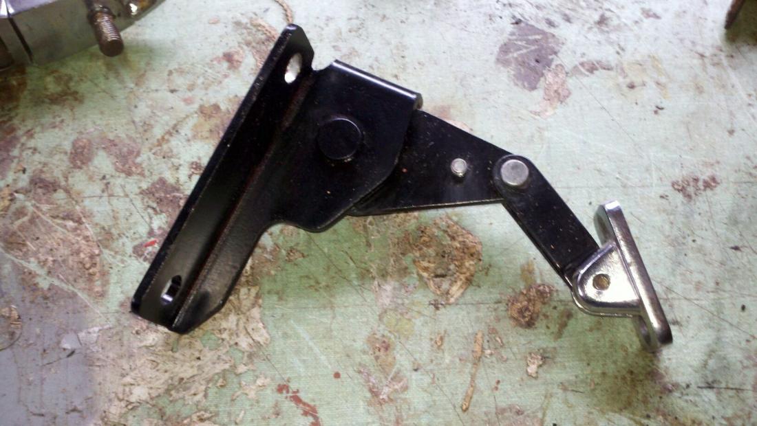

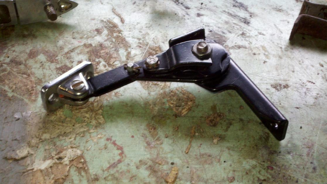

Here is the door check strap that I rebuilt.
Cleaned everything on the bench grinder and powder-coated everything satin black except for the chrome piece.
The other one is almost done except i broke the threaded rod off the base bracket (let me know if anyone has one!)
Is the threaded rod you refer to the one that you tighten to put more fiction on the washer to hold the door open? If it is, then know that the one for the left door has a regular right hand thread and the one for the right door is a left hand thread. It was designed that way so that when you open (swing out) either door, it will automatically tighten the friction washer and hold the door open.
I've had to replace both sides twice over the last 50 years as the threads tend to wear out. When I replaced the left hand side, I just removed the old bolt and welded a new bolt in place. When I did the right hand side, I couldn't find a left handed bolt so I bought a length of left hand threaded rod and welded a piece of that in place.
The last time I replaced the bolts, I made then about a half inch longer that original and used a "coupling nut" in place of the standard thickness nut. The bolts tend to wear the threads out where the nuts ride each time you open the doors. I figured the 'taller' coupling nut would give me twice as many threads to spread out the wear. The coupling nuts are about 3/4 tall vs. the regular nut at about 3/8" tall. I made the change about 10 years ago and everything still works find.
I'm guessing it was the side with left hand thread, it was one of the first things i took apart on the car and don't exactly remember how it sheared.
Maybe the threaded portion broke off because you did not realize it was left hand thread and rather than loosening it you were actually tightening it until it snapped?

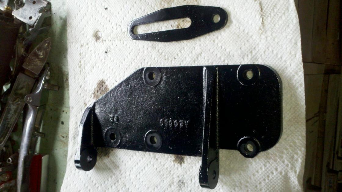

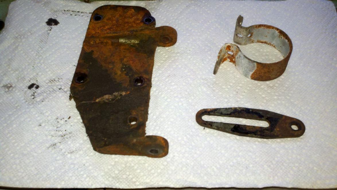

I've been busy since I have to go out of town for a couple months. Trying to get as many parts as possible cleaned up and powder coated. Here is a before and after of the brackets for the generator.
That generator bracket also serves as a tappet cover and should technically be painted engine color. It's not a big deal , and I'm no stickler for complete originality, but the engine does look a little better all one color. I think you CAN paint over powder coating, but it will probably require some special prep.
it doesn't require any special prep and can be painted over. I'm not planning on going to exact with colors. The block and trans will be painted green, as for everything else I will see how it looks. Right now i'm just powdercoating everything for the longevity of the coating.
