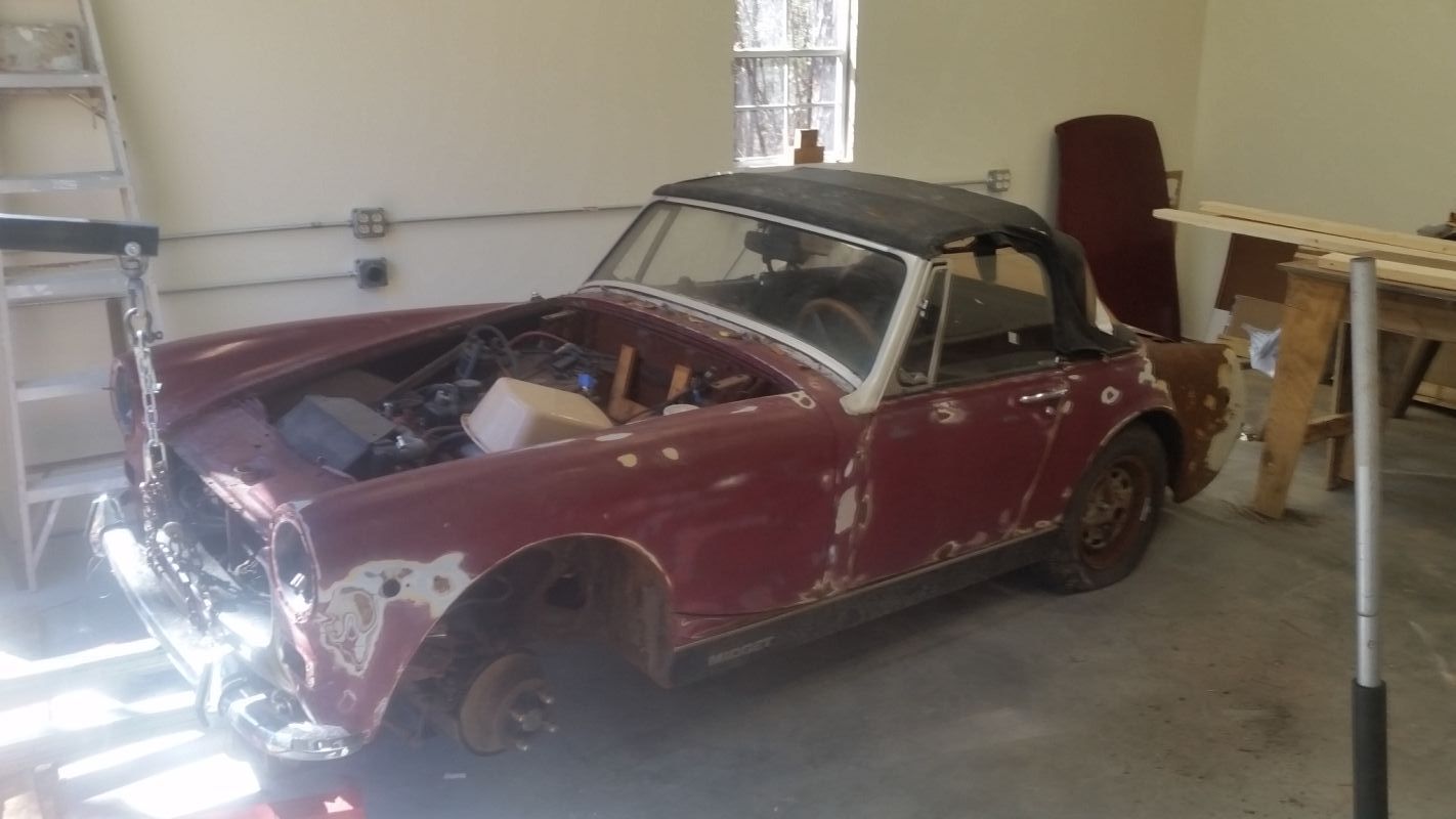

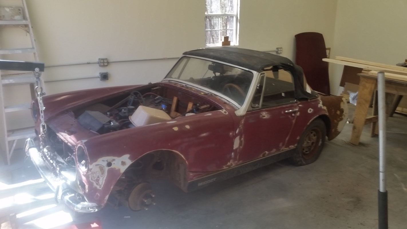

We have the MG Midget in the shop. Now I can find out what I have got myself into.

quite a project!
Bayless
So now the fun begins. I think that will mostly buff out.
grichn
I have restored several Midgets and have lots of bits left over to prove it! They ranged from a USA car , (I live in Spain now), to a Californian car I found on a driveway in Liverpool where it had languished for 15 years.... You will have a load of fun with this car, take your time, I usually take 6 months to go from wreck to pristine. Good luck!

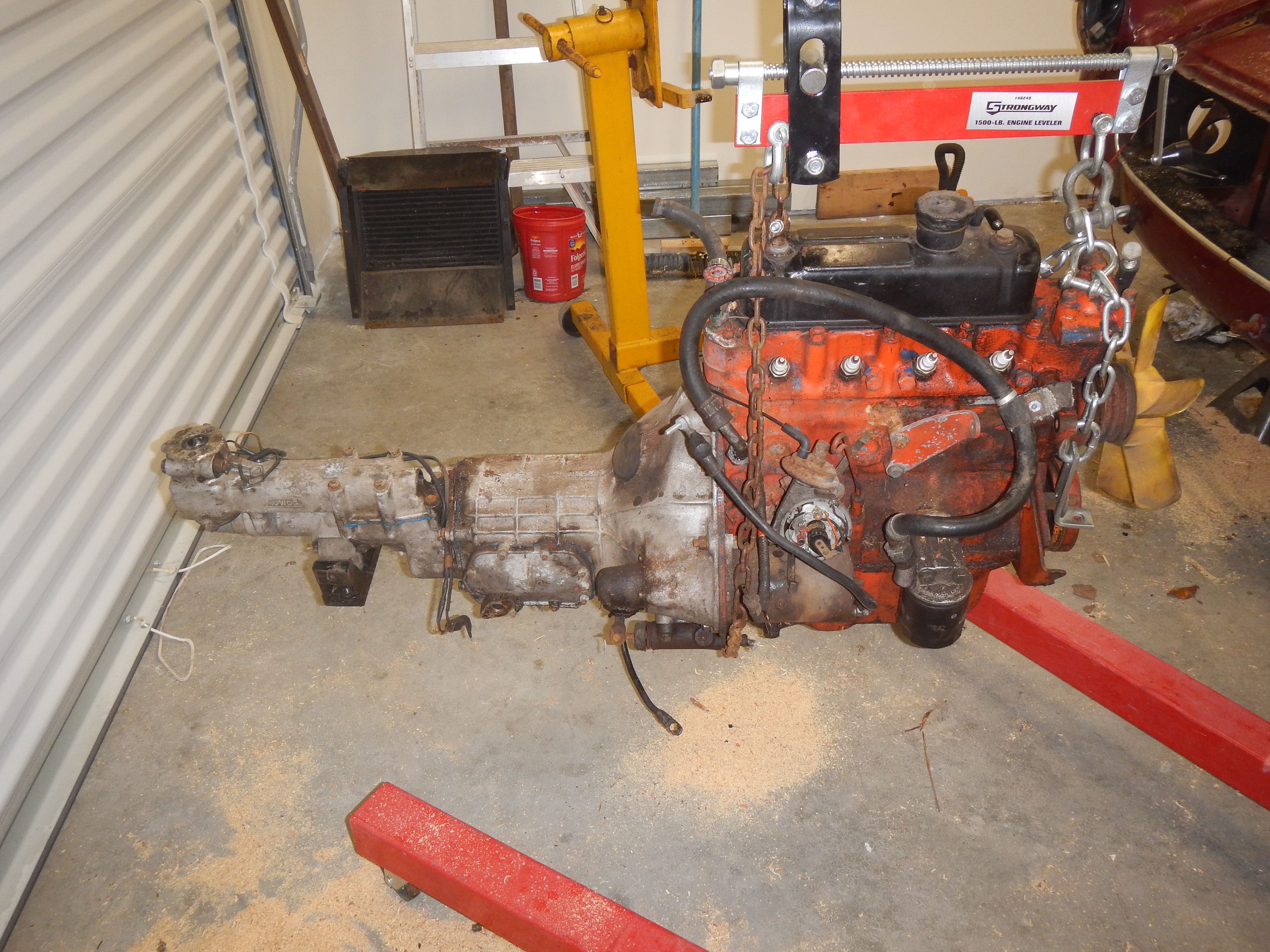

Engine and transmission are out. I think I will get a compression tester to see where I am starting from.
The car came with an oil cooler. The hoses for the oil cooler are huge for such a small engine. You can see one that I have looped back from the inlet to the outlet to keep trash out of the system.
They make getting to things like the distributer tough.

Giving it a better look over the body seems in good condition rust wise. There is a bit of damage on the drivers side rear that has been bondoed up. Will dig that out and all the other patches of bondo I can find. In the boot passengers side the rear spring hanger has a small hole along the back corner. No other rust in the area that I can see at the moment. Will remove the rear spring hanger to get a better look.

Got the engine and transmission separated and it looks like a clutch is needed as the friction disc is worn a bit and the pressure plate pressure pad seems to have some cracking.
Spun the engine over to do a compression test. Not very good at 30, 30, 50, and 60. but the oil pressure was good at 60. I knew I was going to do an engine overhaul but was interested to see how bad it was.

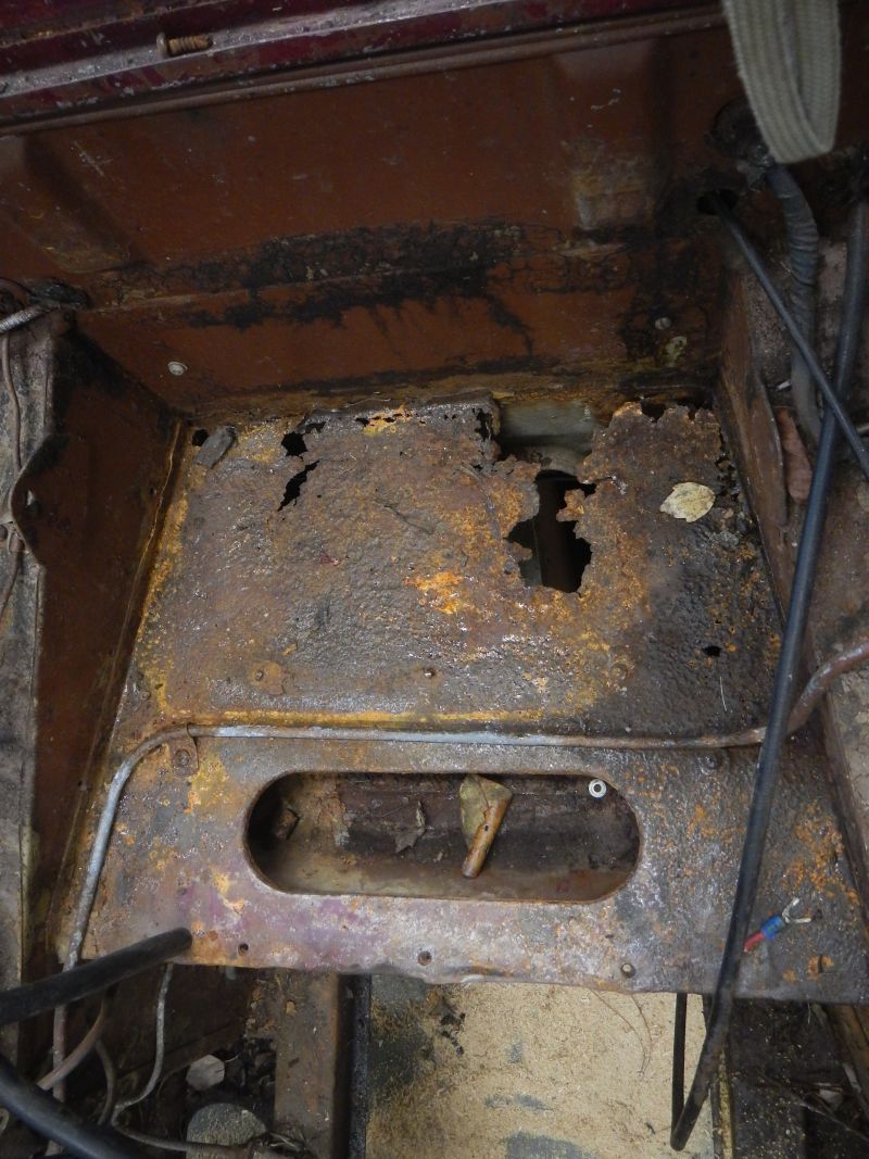

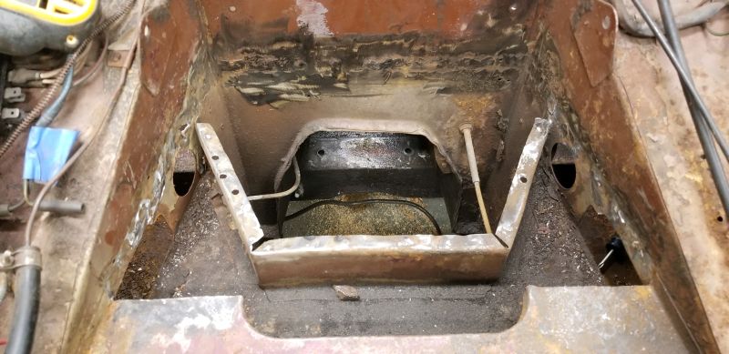

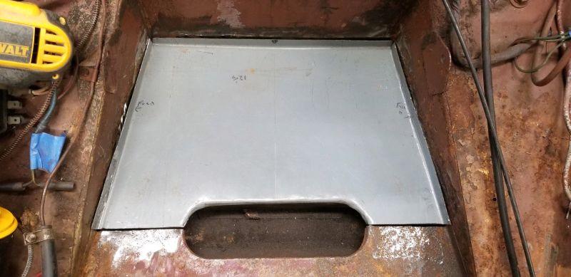

Making progress on the battery shelf area.

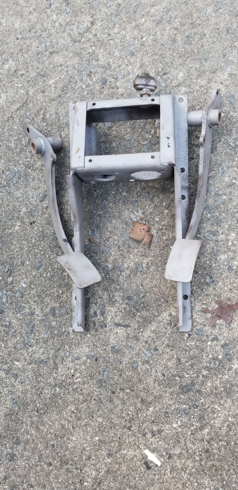

My HF sand blast cabinet works great now since I did some mods to it. The final one being to add a blower from an old vacuum cleaner to keep the dust clear in the cabinet.

Incidentally the material is repurposed Bank storage shelving.
Some years ago a local bank donated a lot of shelving to the school where my wife is a teacher. When the school had picked out all they needed they asked if anyone wanted the remaining shelves. I jumped at it and have been repurposing them ever since.
This is what the shelf looked like when I got the Midget.
