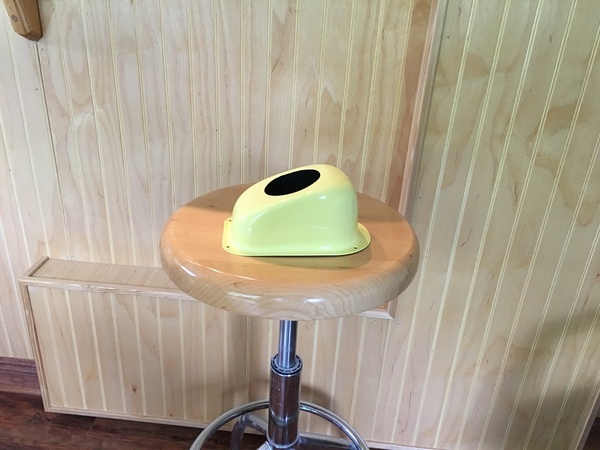

Getting the heater box sand blasted so I can repair the rusted mounting flange. It is nice to get one part done painted and put away. It means you are on the road to a finished car.

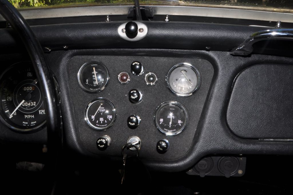

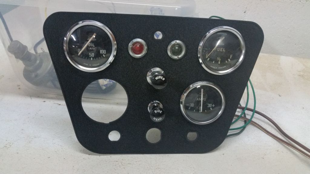

My TR3A instrument panel taken a month after I brought the pile of parts home.
David

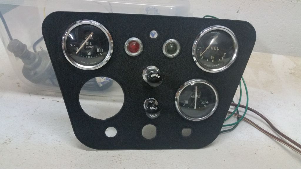

It's a thing of great beauty David. Spackled paint even?
Does anyone know why it is so difficult to get rattle can krinkel paint to krinkel?
Never used rattle can but regular krinkle paint I used years ago had to be put on really heavy.
What I used was rattle can paint. Put it on heavy then I seem to remember using a hair dryer or heat gun to get it to wrinkle.
David

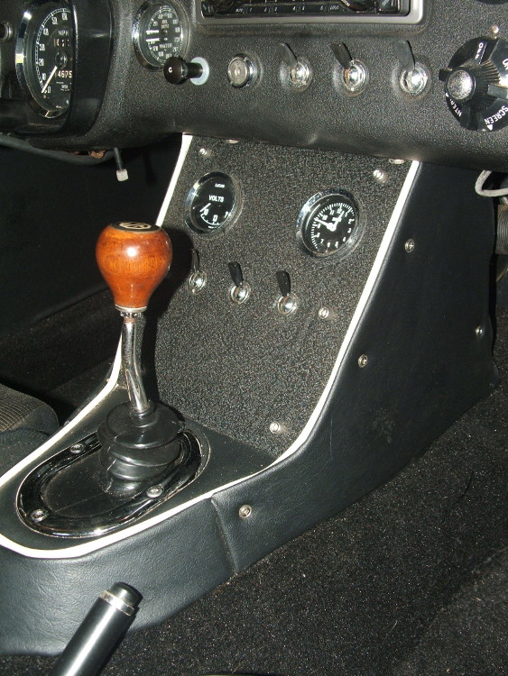

We've used rattle can "Plasti-Kote" wrinkle paint with good results. An advantage here is the Florida sun. The MGB dash and a console finished with it that I made to accommodate voltmeter and clock, along with switches for driving lights, air horn switch-over and some under-dash courtesy lights.
I was working for an industrial clock company at the time and we did have an oven to bake dry the painted clocks . Doc yours looks great too.

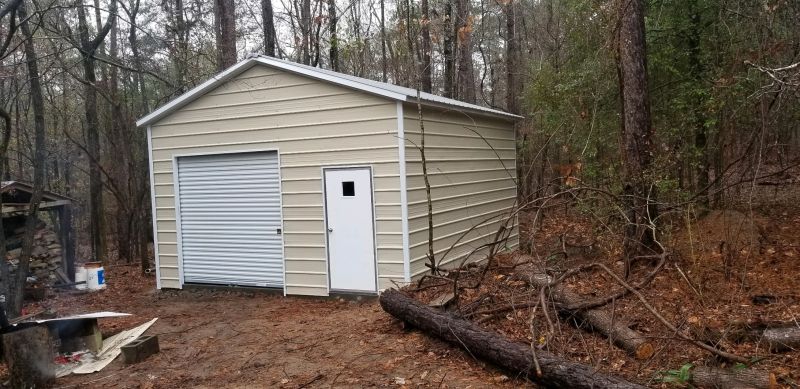

looks like a great shop! well done
