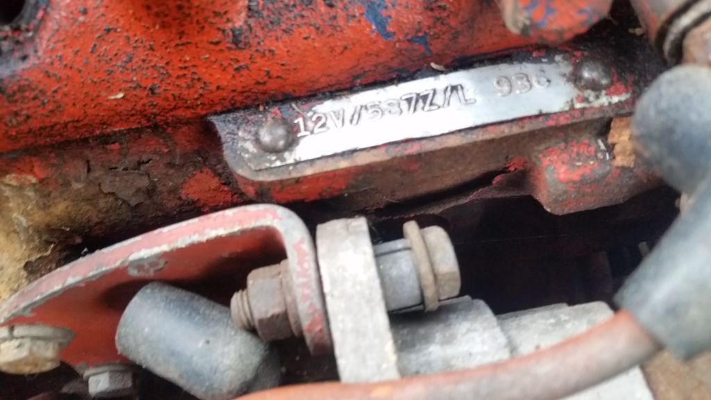

The tag on the block reads . 12V/587Z/L 936

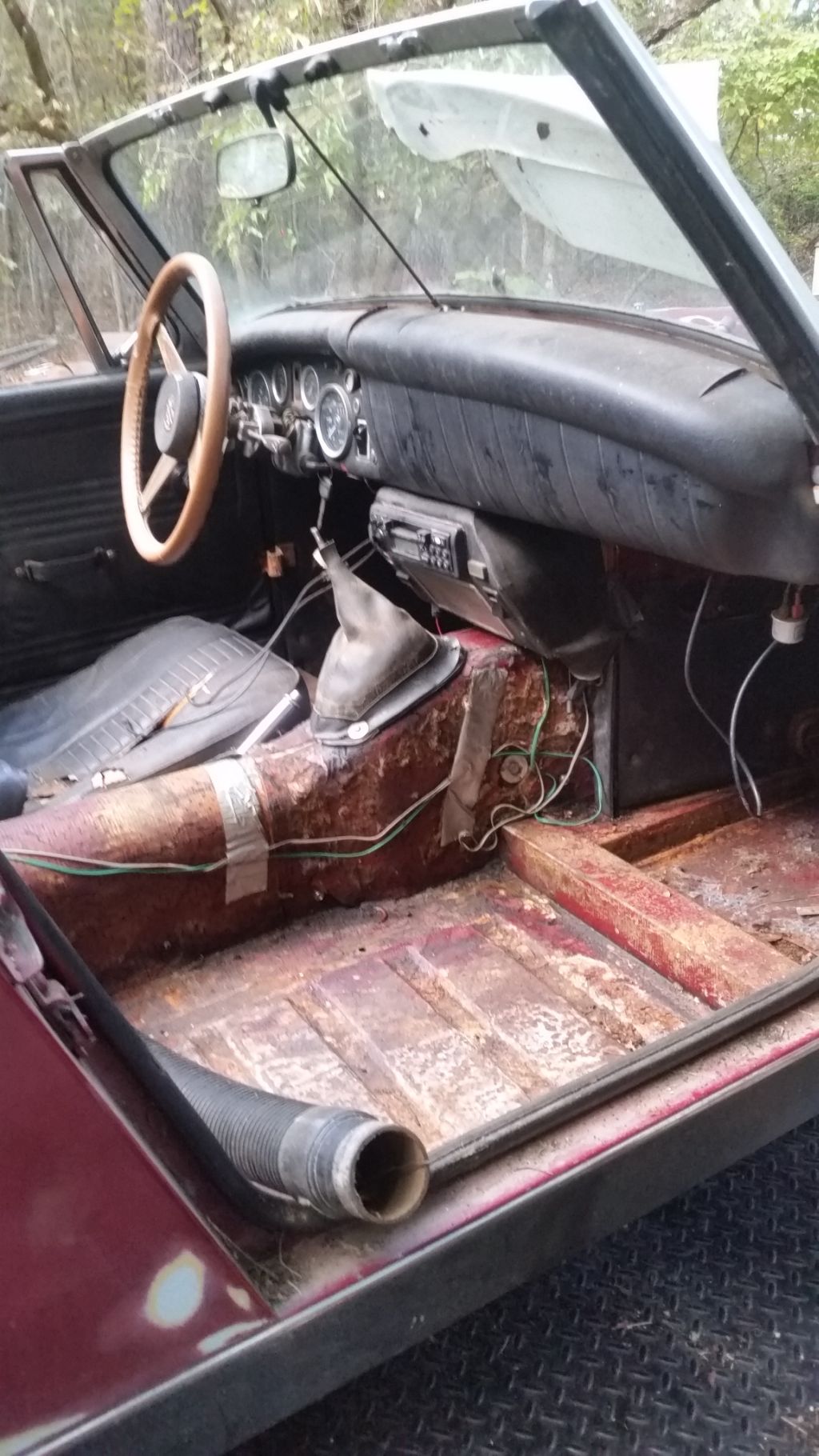

Started getting all the junk out of it and all the carpets out so I can get a good look at the floor. Under the sound deadening material on the passenger side floor I found some rust that I could poke a screwdriver through So some floor work is needed.
Will probable put it up on stands so I can get the wheels attended to and fit OK tires as I found that second hand rollers may be hard to find.
The wiring is going to take some restoration as there seem to be lots of odd wires cutoff but that is down the road.

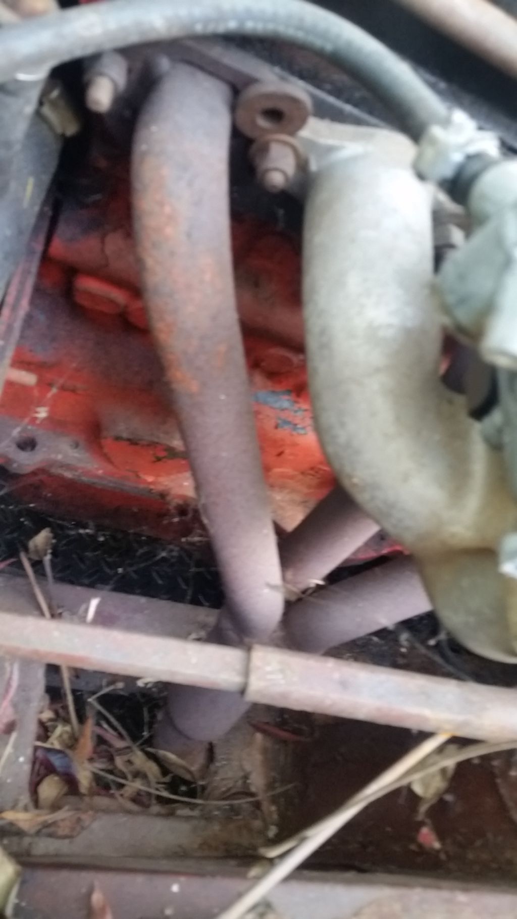

Not sure if the manifold clamps are factory.

The 12V 1275 was the last version of the A-series engine used in Midget. It's a good engine and can be massaged to be quite powerful or just used in stock form. I ran one in my vintage race Bugeye until this summer. The mismatch on the manifolds is because both manifolds are aftermarket parts. Interesting that the radio console is mounted upside down.

I thought the Exhaust manifold looked after market but was unsure about intake.
What carbs normally go on the 1275?

The car came from the factory with dual SU HS2 carburetors. The book most consider the bible on the Midget is Terry Horler's "Original Sprite & Midget". It goes into great detail from the first Sprites to the last Midget on how they were built and fitted out. The Bentley manual is in my opinion the best service manual. It is a reprint of the factory manual and includes drivers handbooks. Haynes manual is ok in a pinch.

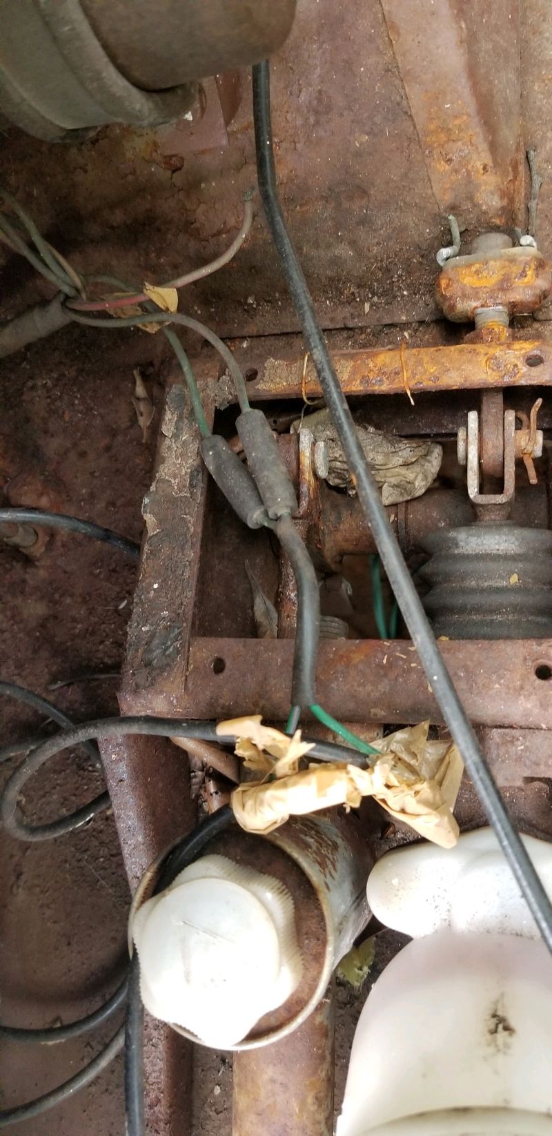

Found some rust in the floor. Drivers side is not too bad and the passenger side will require more work.

Carbs and manifold are easy to find, they pop up on ebay all the time. I would try to find a set from a later A-series Midget ('70-'74) as they have ports for a crankcase ventilation system that works really well and does not use a PCV valve.

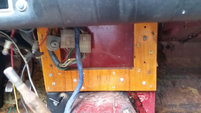

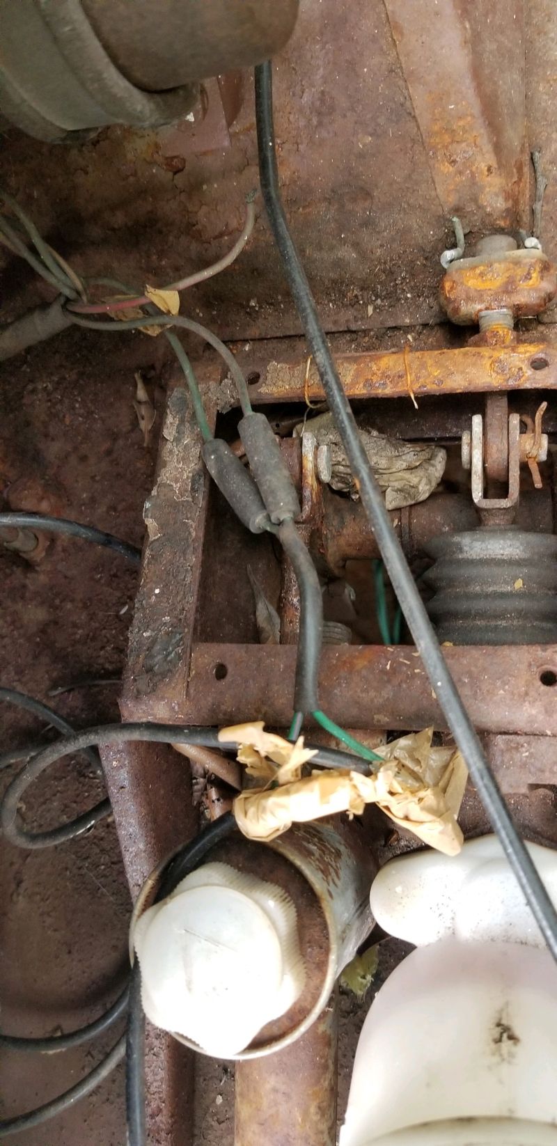

You have got to love DPOs wiring mods.

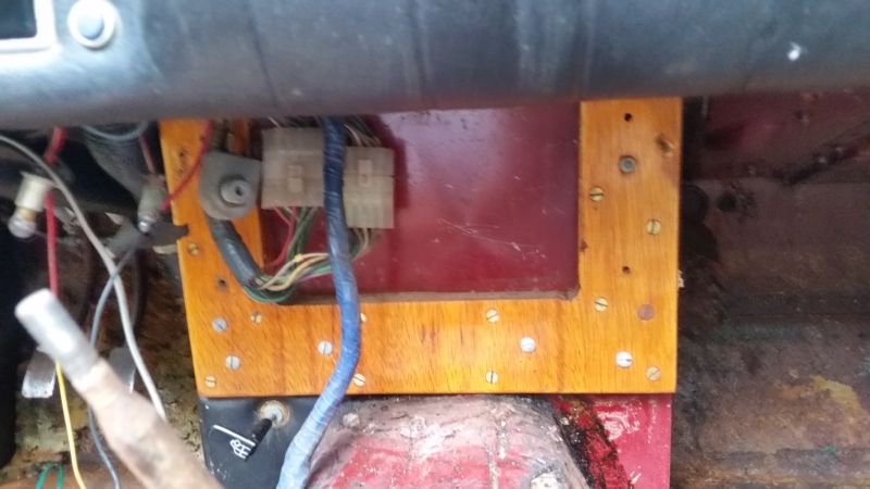

Is the piece of woodwork factory? Trying to remove all the PO additions. I am assuming it is not original.

Not sure what that piece of wood is supposed to be, but it's not from the factory. 😁

No wood in a Midget.

Kind of what I thought but it is best to ask. Have to find out what is under it. Hope the floor does not drop out when I take out the last screw.

Actually there were wood strips under the seat frames until August of '65. But you can't see them unless you take the seats out. 😁

I have found a wood strip along the back of the seat frame that is used to tack the seat back together.

are you sure it's not a Morgan? 😁 (No wood in a Midget - at all)
