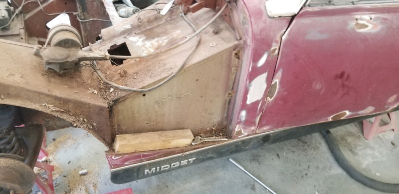

Got the drivers side wing off today. The only surprise was the piece of wood and adjustable wrench laying in the bottom of the wing cavity. There is no rust in that area and the wing looks great as well.

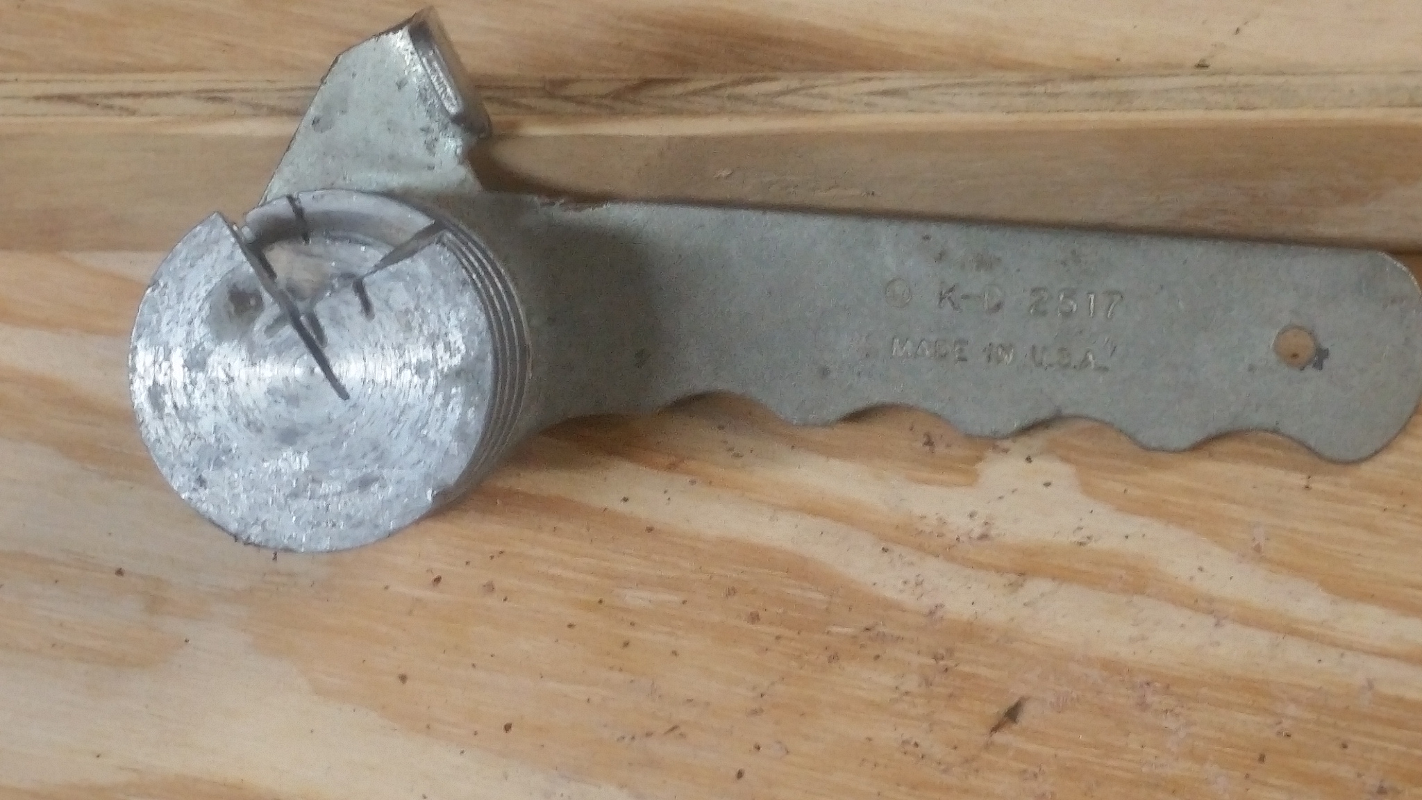

Borrowed the brake pipe flaring tool today.

wood don't rust :ROFLMAO:
Looks as if that Crescent wrench has held up well, too.
It is a cheap Crescent wrench. I will have to remember to watch out for tools disappearing down there. The TR3 has a similar trap but it is confined to small tools and bolts.

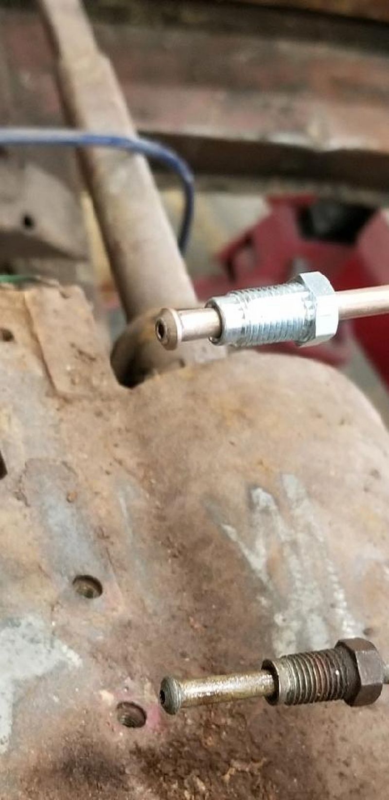

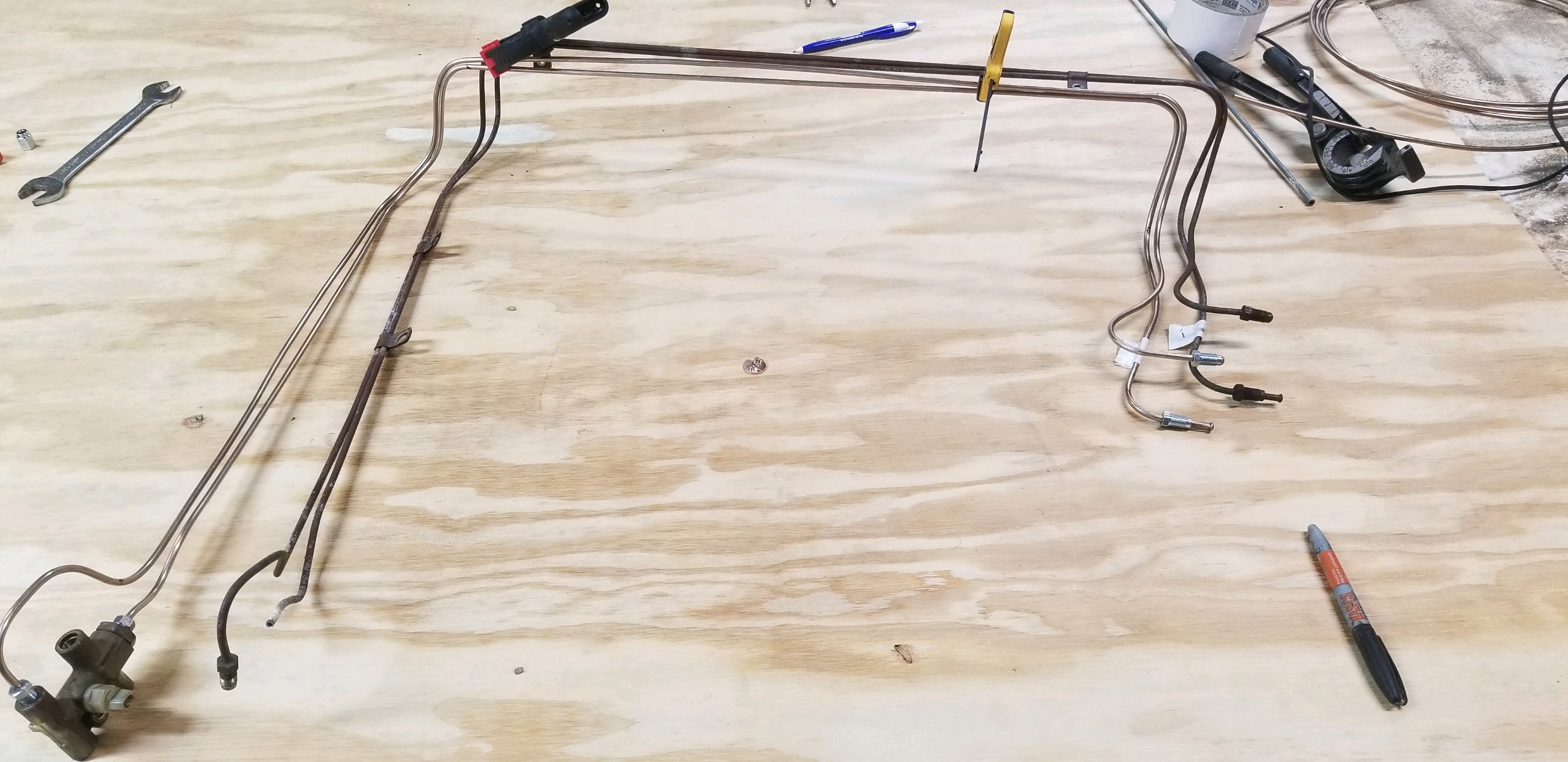

I did find out that the brake line fittings are not all the same. Seems the front brake line nuts at that 5 way valve are a bigger thread than the rest of the nuts. I had to cut the old ones off and reuse them. The lines for the Brake MC to the 5 way valve.

Nice job of duplicating the lines, David. That's always fiddly work. Kinda like snake wrestling! 👍
Thank you. I hope they will fit when I get to that point. Trying to decide which side of the pipe the bender should go was a bit like trimming your beard in the mirror. I always turn the scissors the wrong way.

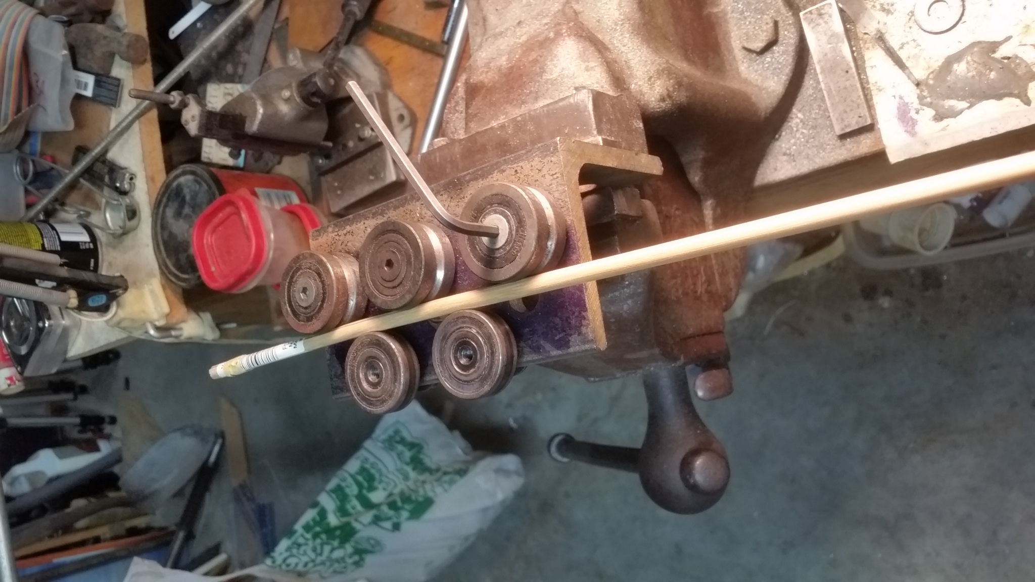

I did make a tool to get my pipe straight before I started with the bending. The dowel is only to demonstrate how it works.

It always seems to take that double check with the bender, as in itself it's a diabolical device! 😉
Your tubing straightener goes "one step beyond"!! A scaled down version of the same principle the machine used for oil well tubing 2.50" diameter and up, where I'd worked in a steel mill as an inspector decades ago. A sixty foot long piece of that material if bent, sounded like a trainwreck going through that thing.

I made the bender from parts salvaged from one of the machines the company I worked for made. When ewe did an overhaul on the machine those guide rollers got changed and for some reason they always changed the shafts as well. I would keep some thinking they will come in handy one day. They did.
The best bender I have is the simplest one. The other 2

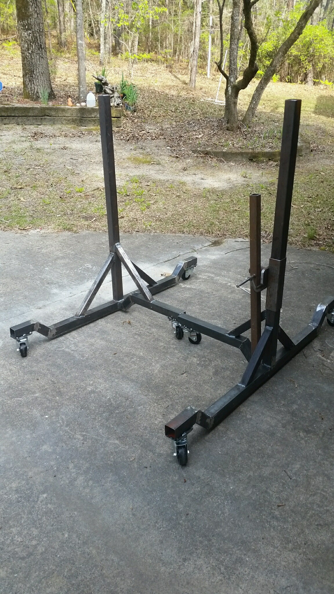

The Rotisserie is taking shape. Should have it in operation in a couple of days.

You're turning it into a work of art, David!

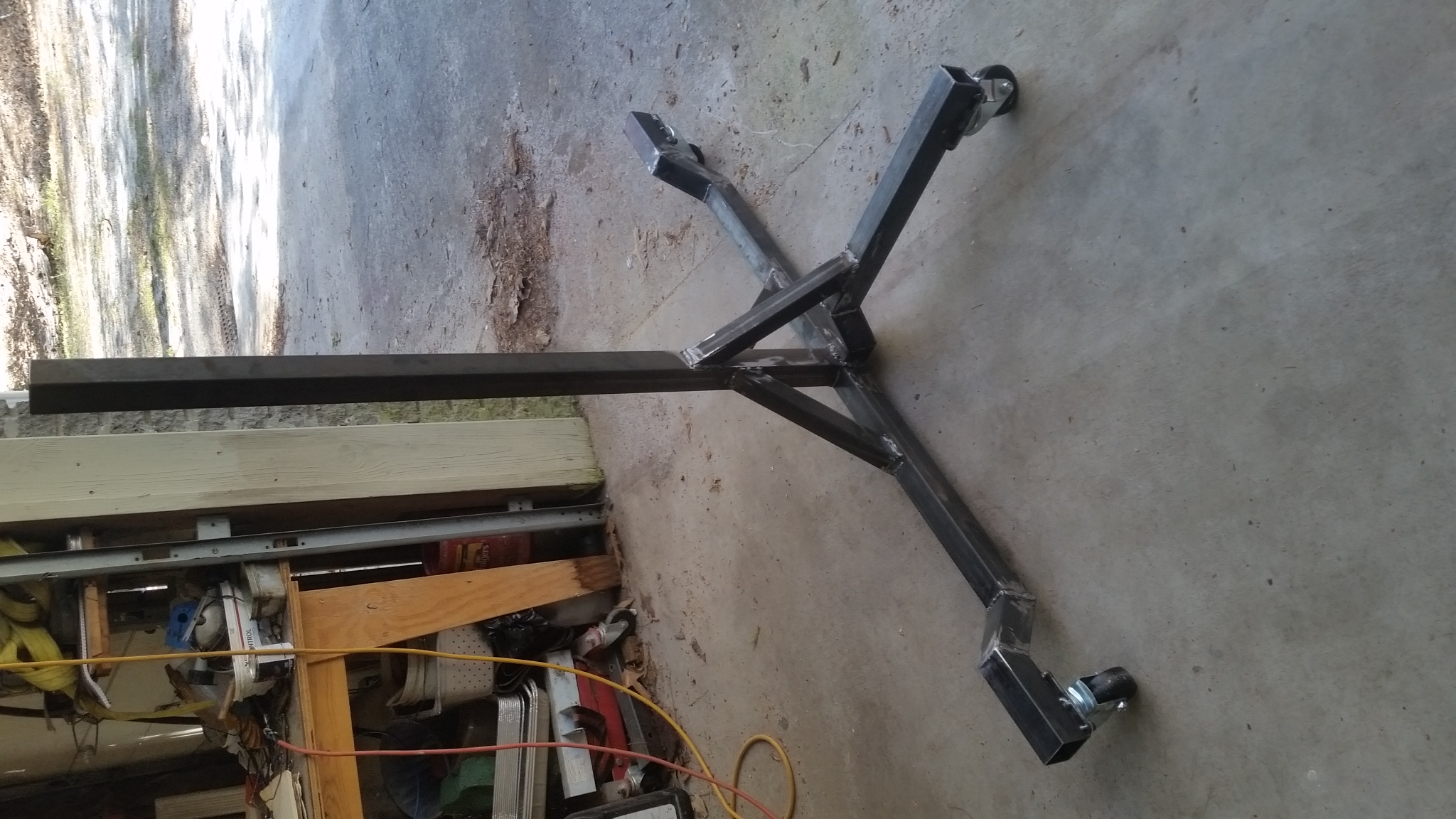

Thank you. My welding is improving. Lack of practice. The second tower is done and the turning device seems to work.
Got the passenger side wing off and was very pleased to find no rust behind it. No tools or wood either. When I got the letters off the side there seems to be some kind of pocket left in the steel. Is this replaceable or should I try to get them out?
