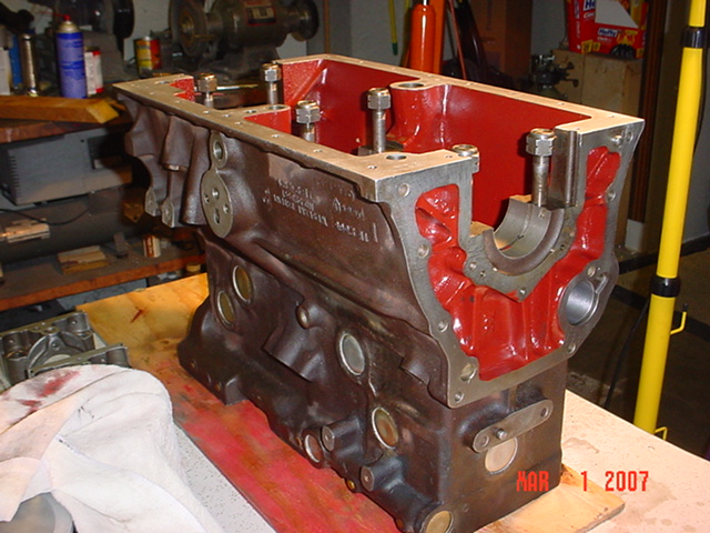

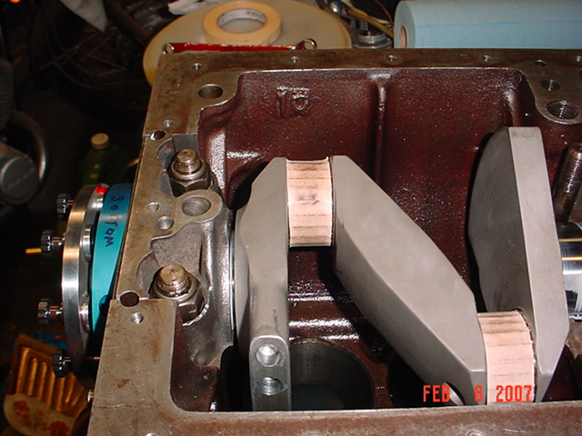

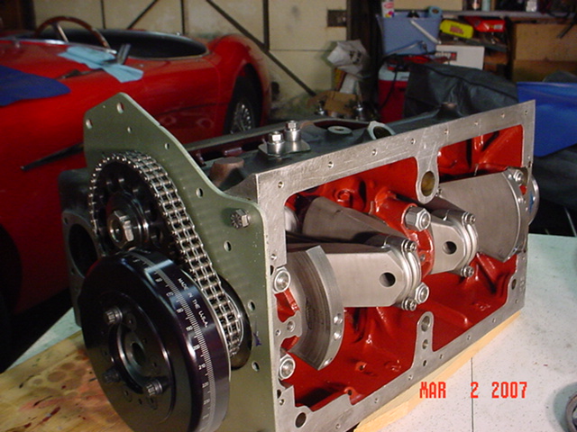

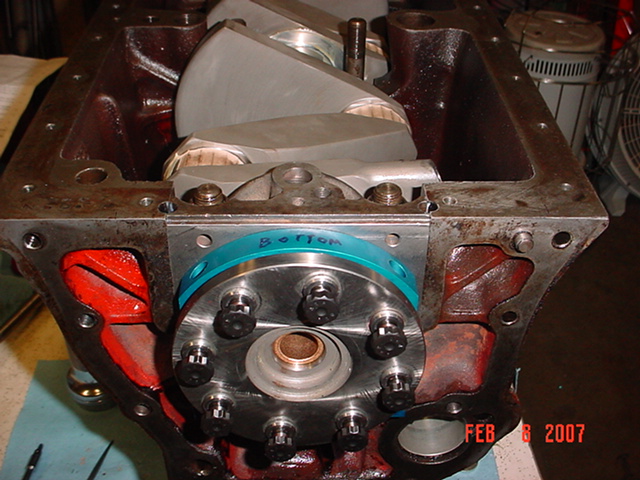

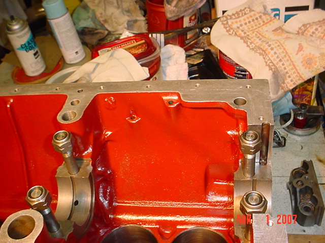

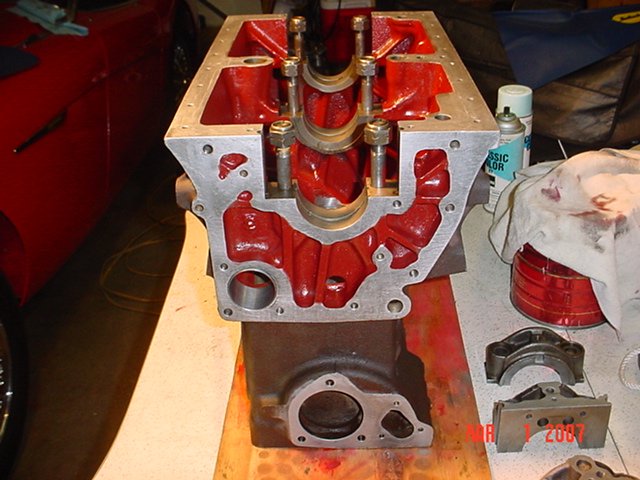

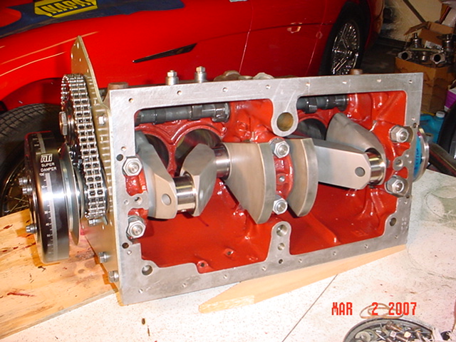

Alan,
Here are some detail pics of my block, crank, etc. As I said, the front & rear main caps are a deep press fit on their sides. The center cap is a shorter press but still pressed. I made a tool similar to the one shown above. Additionally, the front & rear caps are bolted to the front & rear engine plates. A very strong bottom end but not easy to get apart or put back. It WAS used as a 22/1 compression ratio taxi diesel engine. Sturdy enough to run a 4 3/8" stroke at 6,000 rpm plus. (with the right crank, rods, pistons, & harmonic balancer. Maybe the attached pics will help.

healeynut
healeynut
On reassembly can you just tap the caps into place with a mallot, then use the bolts to pull it the rest of the way in?

Dave Russell
Yoda - R.I.P
Yes - Pretty much so. Make sure that the bearing shells don't jump out of place while tapping.
