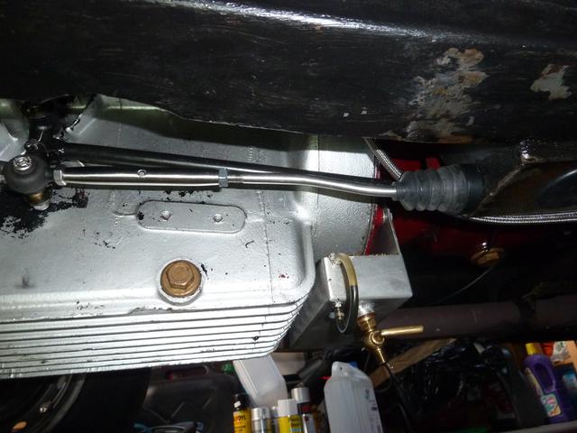

One solution is to attach drip pan to engine as shown which must be drained every so often.
Mike
