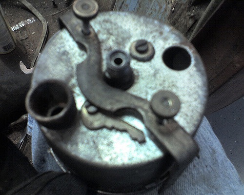

When I got my car it did not have a key either. When I took the dash apart I found a key attached to the speedo. I understand they may have left the factory this way so the car could be moved during shipment. Worth a look.image.jpg
Regards
Paul

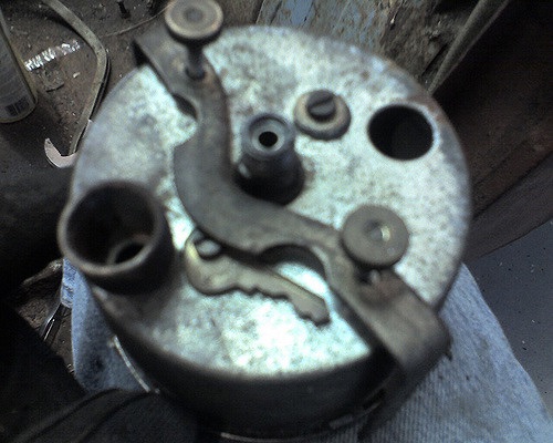

When I got my car it did not have a key either. When I took the dash apart I found a key attached to the speedo. I understand they may have left the factory this way so the car could be moved during shipment. Worth a look.View attachment 44488
Regards
Paul
One of my 67 TR4as still had a key in the right rear tail light the way it was shipped, still wrapped in the original paper.
Rut
