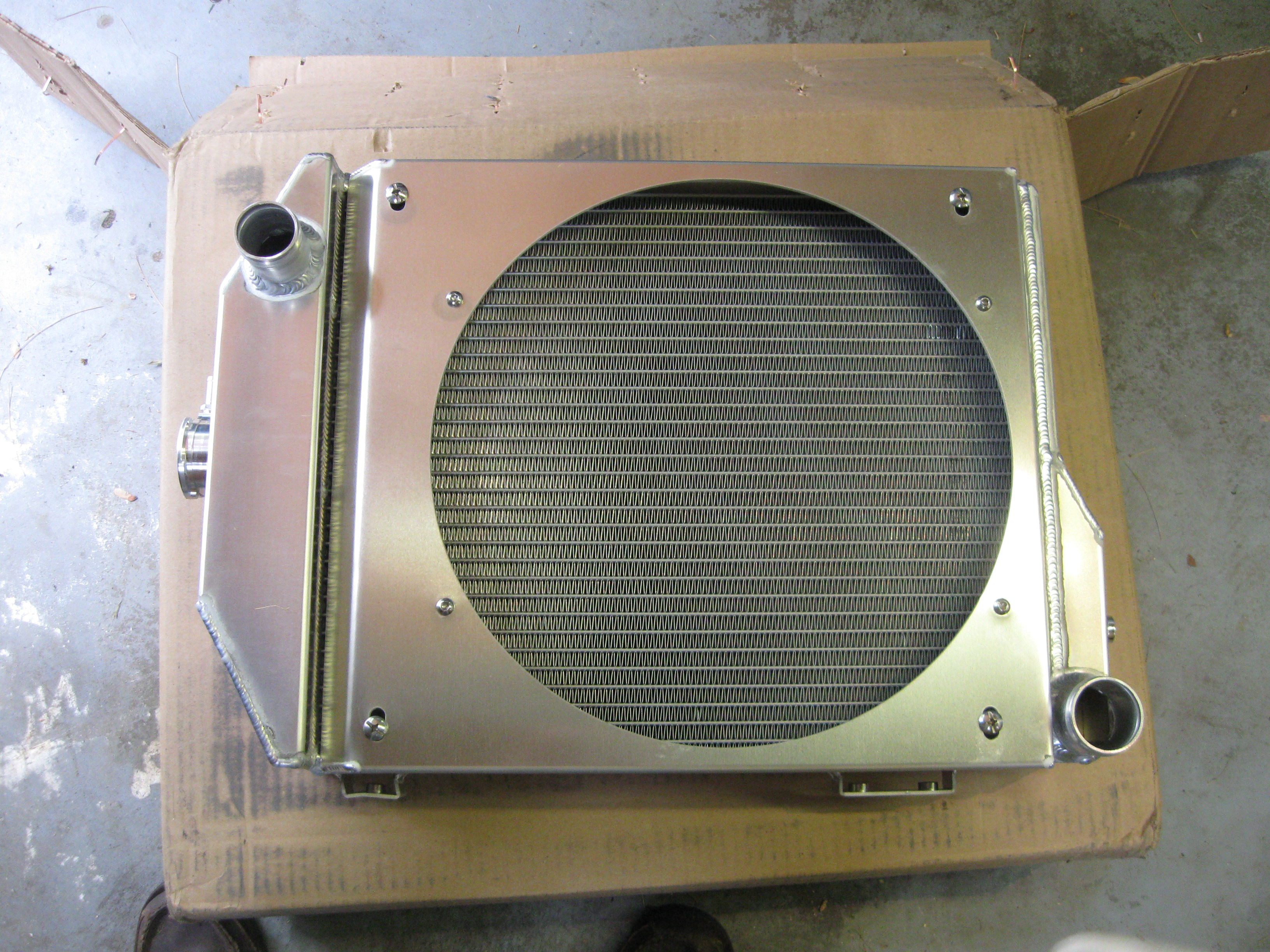

I've got nothing but good things to say about Wizard. Keeping a V8 cool in a Healey isn't an easy task, especially considering the space considerations that limit the size of a radiator that will fit. All the info I could find said a pusher fan isn't ideal as it blocks incoming airflow. Wizard worked with me to modify their Healey radiator to move the inlet to the opposite side to match the Ford water pump and add a shroud to work with the Maradyne fan I mentioned above as a puller. Their workmanship is top shelf with some beautiful welds.
OH that is a great set up U have there NICK I really like that shroud
Thanks, Keoke. One would have to do some measuring to see if it would work with the Healey 6 in place. I had to remove the front xbraces for the shroud and move the whole radiator forward so I could just eke out enough clearance for the puller fan. But that's the way it is with Nasty Boys, sometimes it's a game of millimeters, not inches.

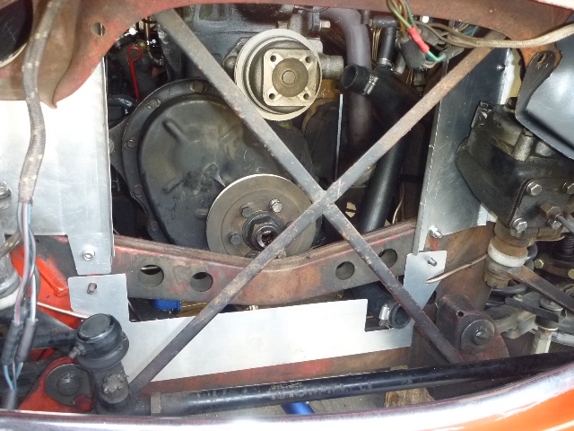

Make spacers on the radiator lower mounts and make brackets for the upper mounts. Have a bung added in the radiator tank for temp control for the fan.
Make a shield for the top area between the radiator and front shroud. Make another shield for the bottom of the shroud to the crossmember under the radiator.
At least for right now, that’s what I’m thinking.

Yes, there are baffles in front to keep air from going around the radiator sides, a two-piece shroud on the back so the Texas Cooler pulls from the radiator and not from the sides. The 13" Spal is mounted in front of the X-brace, so there is a shroud on the Spal exit so all it's air goes straight into the condenser. I see you eliminated the X-brace, so you could mount a pusher against the condenser. Because of that, you should be able to fit a larger Spal. Where mine is located, it comes within 1/4" of the steering tie-rod, and has to be mounted sideways.
