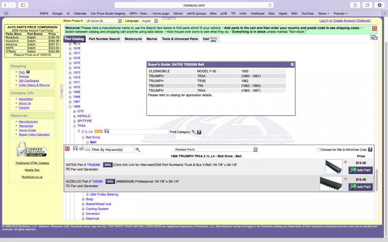

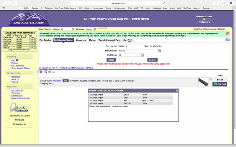

I found Geo's version on RockAuto using part number and a different part number and spec searching under Triumph. Haven't tried either.
Screen Shot 2015-01-16 at 8.02.48 AM.jpgScreen Shot 2015-01-16 at 8.04.21 AM.jpg
