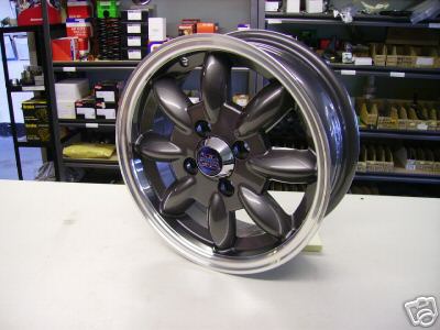

Oh I don't have them yet but I can dream big... Looking at the sumitomo HTR 200. I was hoping for 205/60HR13 but can settle for 175/70HR13. Either of those would keep the speedometer pretty close. I wanted some Yokohama A539 but it is to find them over here. I think I want these wheels.
JC

drooartz
That's quite the wheel. I like that look a lot!

Where you getting the minilite's from? They look sharp. Thinking of those (although am literaly waiting on FedEx for a new weber setup).
Tx-
George

George, those minilites pop up on eBay from time to time. Look for the screenname mgbreaker. He sells them. I think others on this forum have used him.
