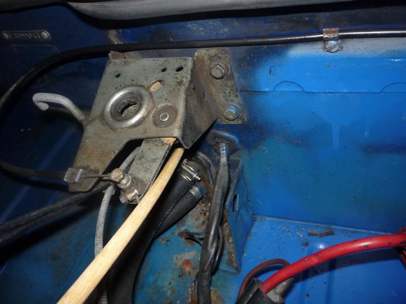

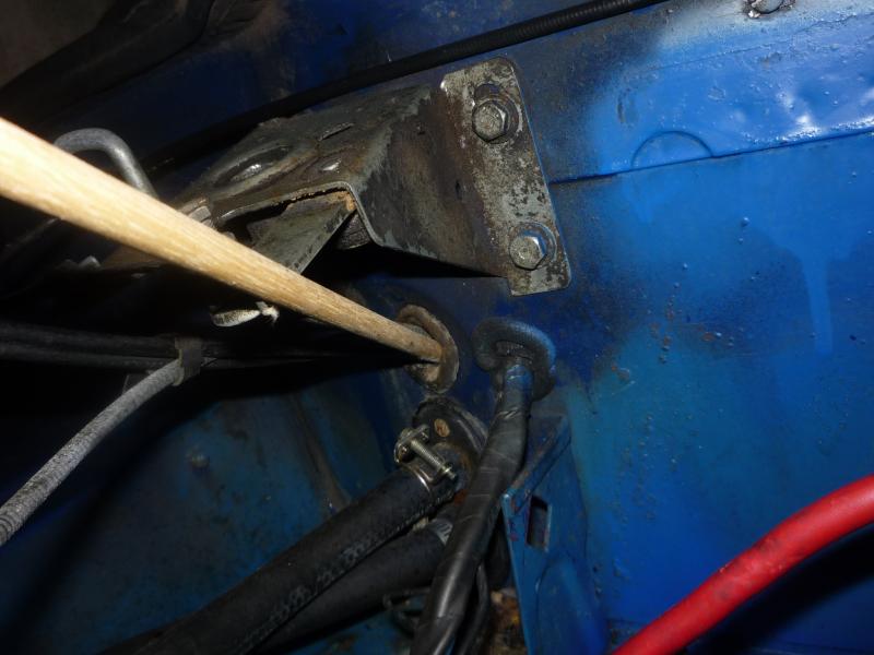

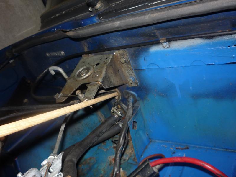

You might get lucky and be able to use a stout dowel to push the catch-plate arm outboard and release the pin. From the inside, insert it through the choke/heater cable opening and go at about a 45-degree angle. If you can watch with your needle camera great - I did it by feel + trial & error. Once in position, lever the dowel toward the center of the car so the other end will push against the arm. It really helps if you get an assistant to push down on the hood above the pin to relieve some 'up' force. In fact, if the hood got misaligned and the cable is just hard to move (and not broken), relieving the up force might allow the cable function one more timek. The pictures show what you're trying to achieve. Don't use a screwdriver since you are perilously close to the + battery terminal! P1100952.jpgP1100953.jpgP1100954.jpg
P1100951.jpg Edit: Looks like the pictures arranged themselves in reverse order...
Gave it another try today with a suggestion received. The emergency one would not push in. The camera helped find it after quite a bit of time getting it into a position to see. Handy thing to have though. I figured just put more effort in the driver side release, but it released after heavily leaning back on it. The emergency one must have slipped past the release when the hood was closed. Thanks for the suggestions and comments :encouragement:

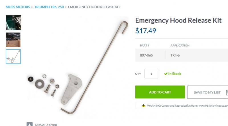

Good advertisement for Moss' emergency hood release:

On my Moss emergency latch, I tapped the holes for both the pivot and stop screws. They can be adjusted to the desired spot or tightness and the locknut on the back tightened up. Not worried about the action becoming sloppy over time.

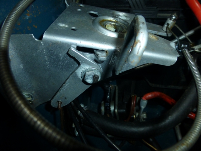

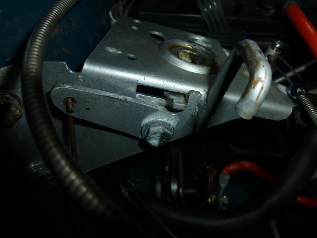

Not sure who produced this one, it was on the car.
Good
Bad
Oh yeah.... you definitely need a stop bolt so the lever arm doesn't rotate past the open position . Drill and tap a small bolt with a small spacer and do as Steve suggests by installing a lock nut on the reverse to keep.

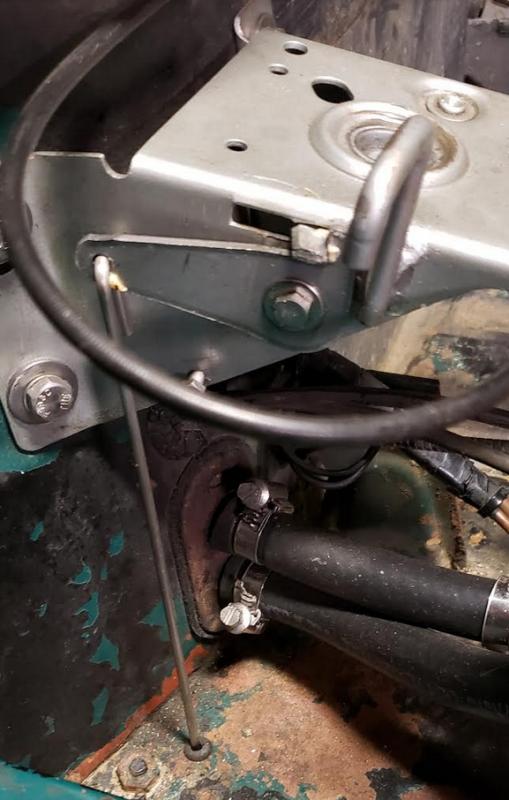

Ralph,
homemade by me several years ago. I have learned to cut and leave tab at bottom of arm that makes a stop to prevent that from happenning.

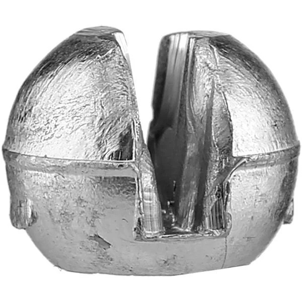

I'll be adding a split shot from my tackle box to the rod that goes into the footwell, should prevent it from being pulled to far. The actual split shot is much, much smaller :smile-new:
