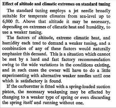

I typically run Marvel Mystery oil in the dashpots. At Snowmass (high Altitude) we went to a lighter machine oil as I recall.
From the SU Workshop Manual.

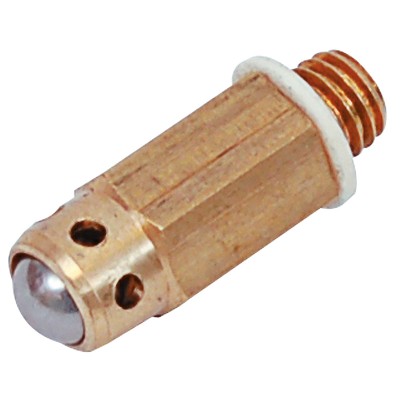

Both sets of HD8's currently have the (per Moss motors description) "Grose-jet, superior replacement" one installed.

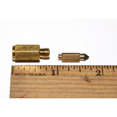

The ones that come in the rebuild kit have the "needle & seat" 2 separate parts, vs the one unit Grose-Jet.
Interesting that the Grose-jet costs less $10.99 vs needle & seat $19.99
I also noticed from the Moss photos, the Grose-jet has a white washer, the needle & seat does not. Should the needle & seat have a washer too?
Is the Grose-jet really better? Why?
How do I tell if the ones we have need to be replaced?
Grose Jets are, in theory, much superior to the needle type. I put a set of Grose Jets in my BJ8's HD8s over 25 years ago and they have performed flawlessly; however, we tried them in our BN2's H6s(?) and the small ball that closes the opening to the fuel line would get stuck occasionally. I heard the company that originally made them got sold; oftentimes quality goes down when a new owner tries to squeeze all the profit they can out of their purchase (pay off a loan, maybe?). If the ones you're now using haven't given you any problems--i.e. flooding when they stick--I'd stick with them.
The needle-and-seat type will sometimes wear a groove around the tip, on the Viton, or other 'rubber' type, and some have all brass needles which will sometimes show wear around the tip of the needle and in the seat. This usually requires many miles of driving; for our occasional runabouts it's probably not much of an issue. The needle-and-seat type will sometimes get stuck, too, but a whack from a plastic or dead-blow hammer on the top of the float bowls will usually free them up. I can see no potential harm in putting a nylon (teflon?) washer under a needle-and-seat type, if you have enough thread and can adjust the float levers properly.
