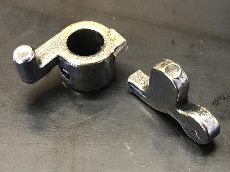

Speaking of incompetent "professionals" seems the drama continues with Dana of SuCarbs. Most likely he damaged one of the throttle stops. I noticed a crack and when I put a little pressure on it, it broke. (Don't even get me started that he didn't returned the carburetor coupling shaft assembly !)
I'm hoping Joe Curto in NY will have one. Moss doesn't sell them. If I can't find one, is there a work around for not having the stop lever?
