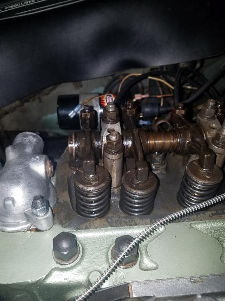

OK pulled valve cover and set to TDC, here is a picture of the valve position for #1 Cyl, both valves closed

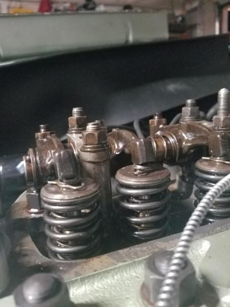

And the engine with timing markView attachment 53024. I also rotated 180 and here is the valve position at that setting.View attachment 53025
OK, the second TDC picture looks about right as well. The intake valve should start to open a bit before TDC, and I think that's probably what it's doing. Have you checked that the valve stem to rocker arm clearances aren't too tight?

The valve timing is probably OK from what I can see in the pictures. If the valve clearances are OK, set up the ignition system. Ignore the fuel system, and try a puff of starting fluid to see if it will try to start. If that is successful, then move on to the carbs. Good luck. Jim

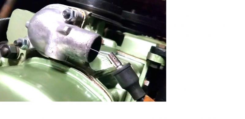

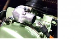

I do seem to have a good spark with it jumping about an inch. The spark does pulse on and off. Is that normal? The color appears to be blue to white spark2.jpgspark1.jpg
Re: trouble on 1st start
You have what appears to be a healthy coil, judging by the picture. The fact that it is pulsing probably indicates that the the distributor is triggering it. I assume that's the coil wire in your picture. If it is, plug it back in to the cap and repeat the test with each of the plug wires, and plugs. Are the plugs gapped correctly?
