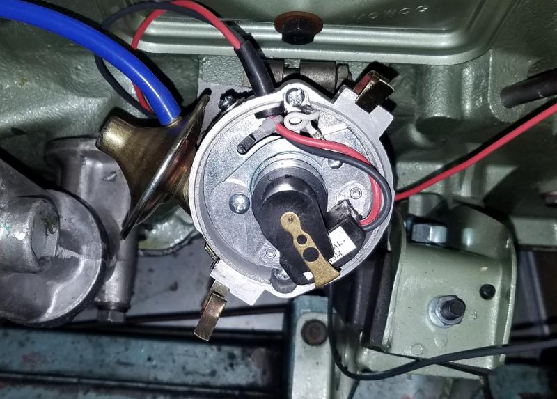

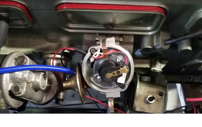

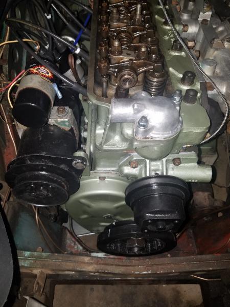

If I understand your situation correctly they don't reach because the distributor is 180 out. When you reorient the leads, ignoring the wire numbers, they should reach.

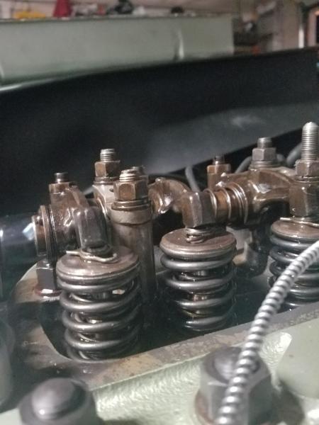

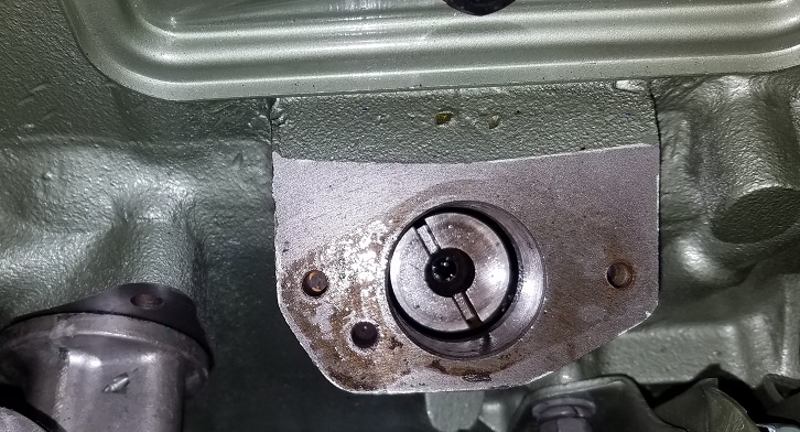

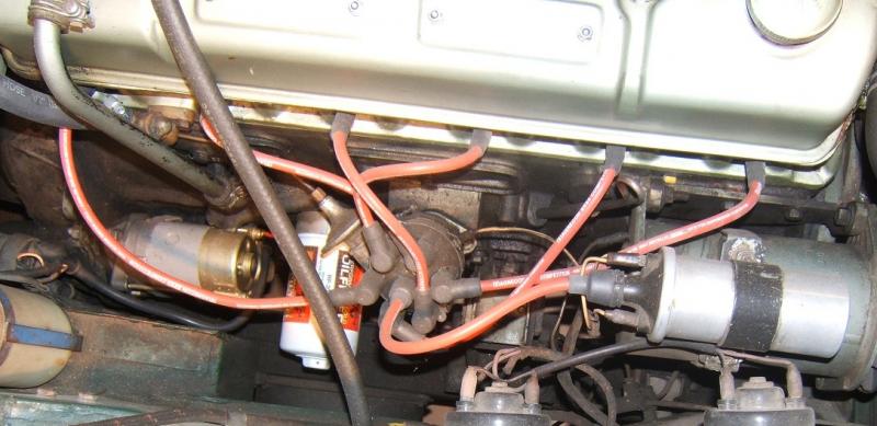

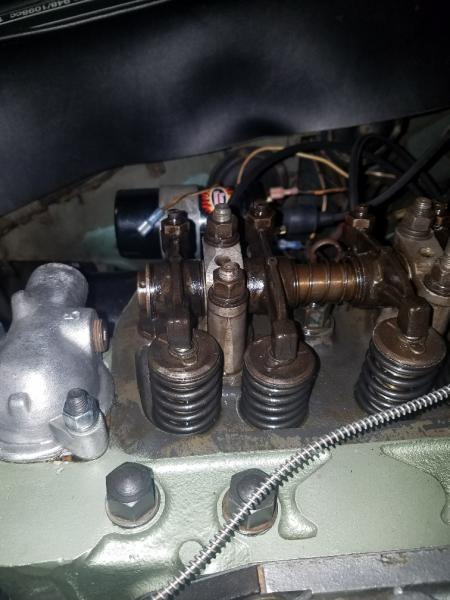

Went through the engine on the phone with the builder and verified TDC( Compression stroke) and alignment of pulley notch. He says it right. The shop is Vellios in Manhattan beach, and I know a few of my local club members have had work done there. Ran into an interesting problem with my new plug wire set , in that I cant reach plug #2 with my wires and my new distributor setting, so kind of annoyed that this new set from Moss doesn't have enough long wires to do this .
