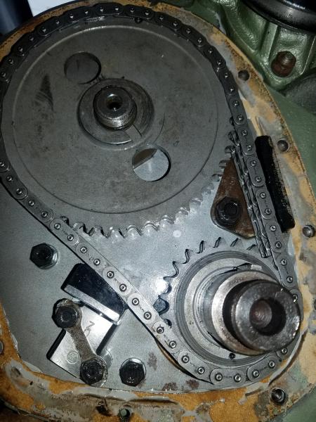

Wow 90degrees. Randy is, as usual, correct, and I apologize if I contributed to the confusion. When you said that both valves were closed at TDC, and the crank and pointer basically lined up, I figured there wasn't a cam timing problem - I mean, the valves were closed, right? Then I looked at a valve timing diagram, and lo and behold, with the cam 90degrees advanced*, both valves look to be "closed", and 180 cam degrees later, the intake is opening (or open), and exhaust is closed. Just like your pictures. The timing diagram is attached (generic, not Healey specific).
Anyway, I'm glad you found the problem. It might be worthwhile to have a friendly discussion with the engine builder. Good Luck, Jim
