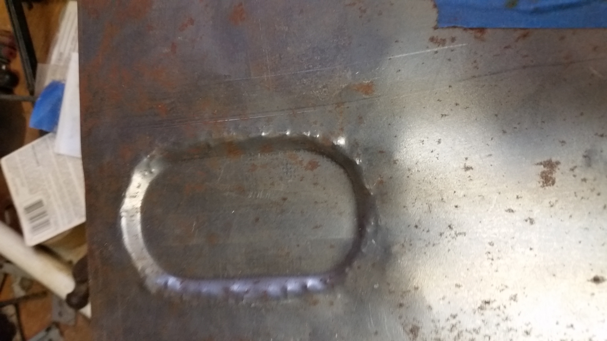

Hi Frank could explain briefly if you have time how you made those dimpled out panels on the back section by your seat. I have been heating the metal and pounding the metal onto a block of would that I have carved out, but it is not working very well.
steve

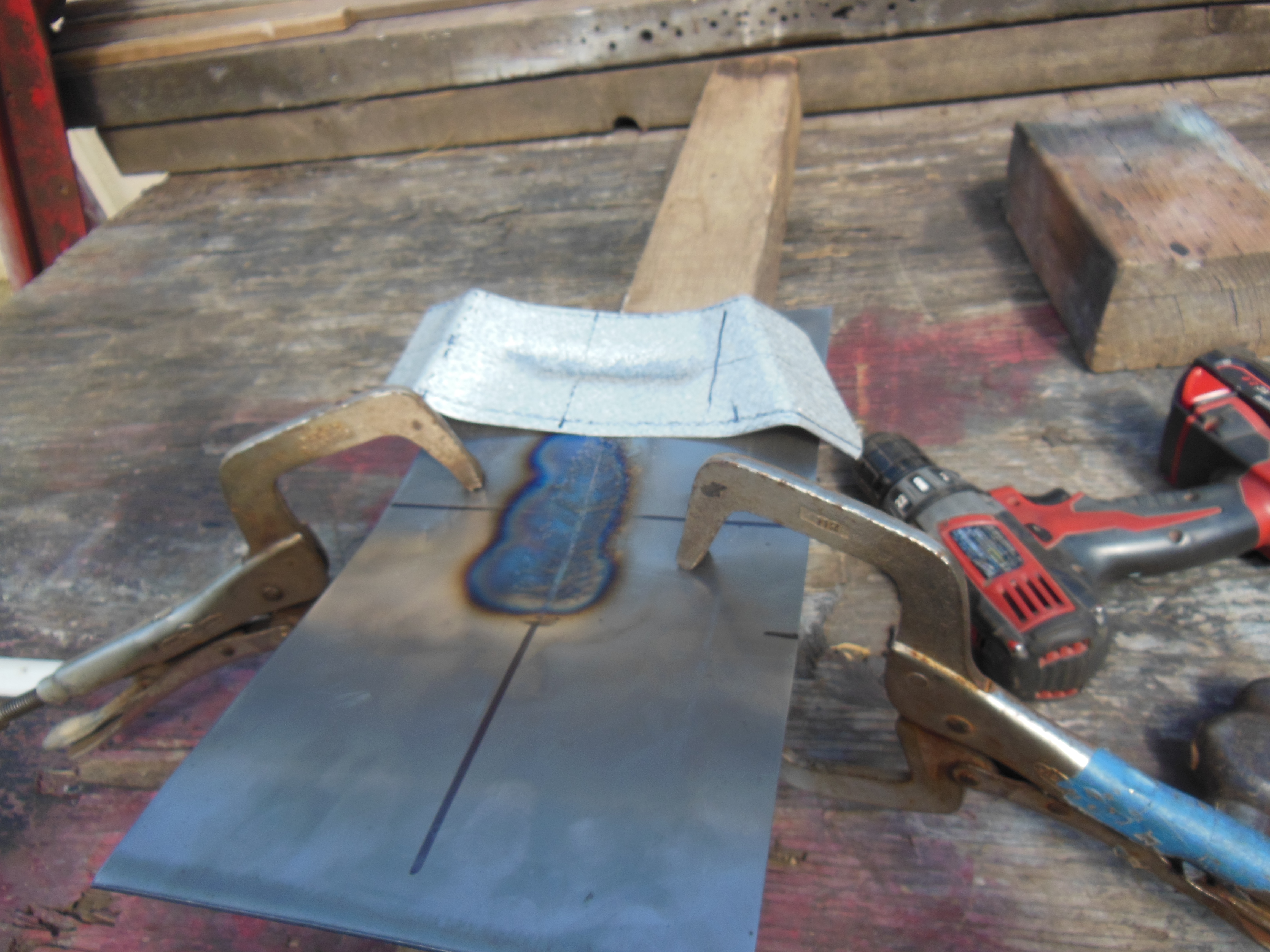

I gave Frank's method a try just to see if I could do it. It worked remarkably well. This was just a test piece.
David
