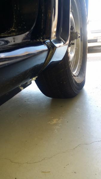

jimstr4
Here's a photo of the gap.

I didn't jack the sills up with a 2x4, should have.
Blast.
The caps needed chopping and jamming in.
I'm going to take the fenders off again and have another look at the caps etc, I think that that area might need cutting and rewelding.

My complaint is these panels various radii on the edges is not as tight as the original panels. I was told the tooling needs to be reworked, makes perfect sense but doubt it will happen.
J
jimstr4
Yep.
That was the F.. UP.
The lack of prefitting and subsequent fettling to match the curves of the guards and door.
Sounds like much welding is in order as well as better shaped outer sills.
