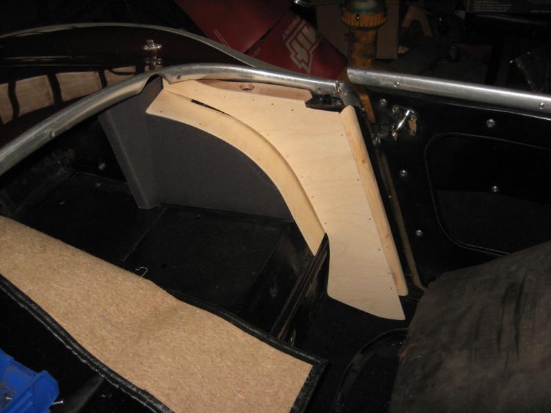

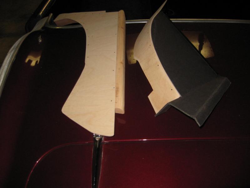

just received a new set...four pieces...of wooden quarter panels for my BN6. can anyone point me to a thread describing the installation of these pieces. i realize that they will need upholstery and i will have that done once i determine the proper fitting. my car was missing these pieces when i purchased it. thanks in advance for your help!
Here's some pictures from when I did mine; the album's of doing the whole interior, but looks like the rear panels start around page fifteen (15): https://spcarsplus.com/gallery3/index.php/Healey-at-home/Interior_Makeover?page=15
Moss initially sent them constructed incorrectly, so you may find a false-start in there of fitting them, I also had to reshape the pieces to fit correctly at the top of the B-pillar (being already upholstered complicated that process, but still doable).
Larry, for greater detail, after opening a picture in the album, clicking on it will present a larger image in a new window; a second click on that will bring up the full resolution image.

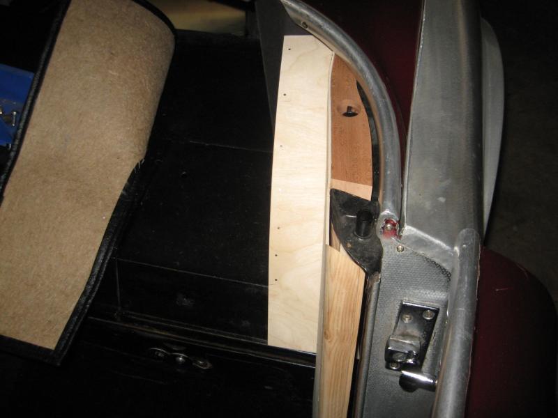

i bought mine from healeywood. they seem to fit the body very well. two pieces to each side. i also have new armacord for the shelf. thank you randy for your response....i have three point safety belt points welded in on the quarter panel and will have to cut openings for that. my main question is how do the upright pieces on the door post area attach. are they attached with screws from the backside of the part?
