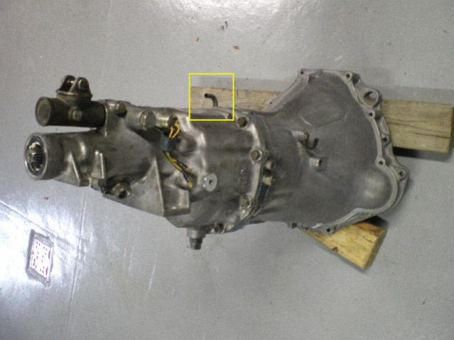

Just curious, have you check your vent pipe or vent hole? Transmission will build up pressure if not vented, enough to push a seal out...
Good point! It wouldn't be hard to smash the tube shut during installation.
I remove the vent tube and cut a round piece of open cell foam for the hole to aide in more room for transmission tunnel.
Top center.
I have seen these covered with vacuum caps.
Thanks for the pic. Looks like its in the most inaccessible place it could be with the trans installed. It also looks very vulnerable to getting squished during install, so it makes sense that it could be the culprit. If it was squished on the install, is it ok to remove it by cutting it flush, rather than trying to repair while the trans is still mounted?
I'm not saying it's not possible, but I have personally never experienced an issue with this getting damaged during install, nor have I heard from anyone else that run into a problem with it. I have them them damaged by careless removal on a couple occasions though. They will snap/pop off, so more likely than it getting squished shut, is for it to just be broken off. The short length and bend make it pretty stiff to bend.
