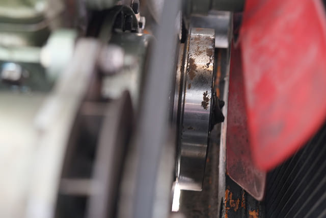

Here's mine complete with with rust and in position.
For those of you who have installed the Pro-Race, any frame cross member interference issues?
Thanks,
Duane
