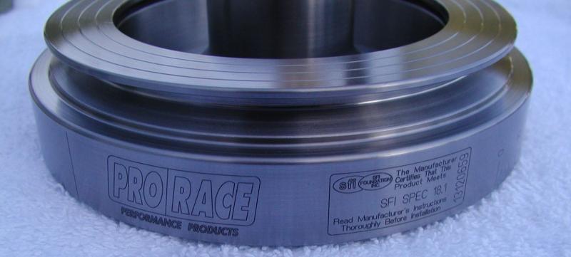

I want to thank EVERYONE who responded to my question, all of the combined knowledge here is truly amazing. :joyous:
After all considerations, and since I'll be driving my Healey allot here in SoCal, I opted for the new Pro-Race.

Yes, the damper came with detailed instructions, including immersing the damper in boiling water for 15 minutes, or in the oven at between 120F -250F (Max.) for 15 minutes, or a professional installation tool. Mine will be installed by my engine shop (Engine out of the car) with the installation tool. I'll take a video if anyone is interested.

BTW, you might want to mark TDC and where you want the timing set with a white mark before you put the engine in the car. While those carefully calibrated degree marks on the ProRace damper are nice, they are hard to see buried in an engine bay, especially with a running engine.

Note that the BP Northwest unit is NOT a Pro-Race, where the AH Spares and Jegs are!
