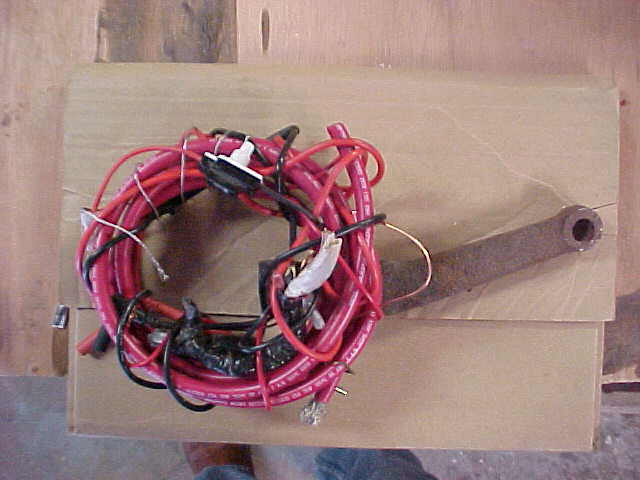

jameswillson, no silly somtin like dis!. see attch. /ubbthreads/images/graemlins/devilgrin.gif

[ QUOTE ]
[ QUOTE ]
... ill roll up some "old" volvo wire and use it as a release bearing?
[/ QUOTE ]
Just a "clutch cable"? /ubbthreads/images/graemlins/jester.gif
[/ QUOTE ]
JW! He doesn't have the faintest idea what chu talking about.--Keoke- /ubbthreads/images/graemlins/thumbsup.gif /ubbthreads/images/graemlins/laugh.gif
