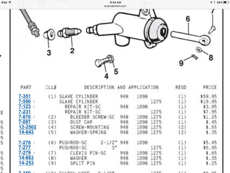

It sounds like you have the push rod for a smooth case tranny the rib case takes a longer rod
smooth 2.5
rib 3"
Gerard
smooth 2.5
rib 3"
The longer pushrod is only used on the 1275 with the 1" slave cylinder, not selected by ribcase or smooth alone. Don't use a longer pushrod to compensate for other issues or you risk bending the fork. See the link in the previous post.

I have long push rod and 1 inch slave. My original post are the new carbon release bearings with roll pin any better, or do they fail early?
