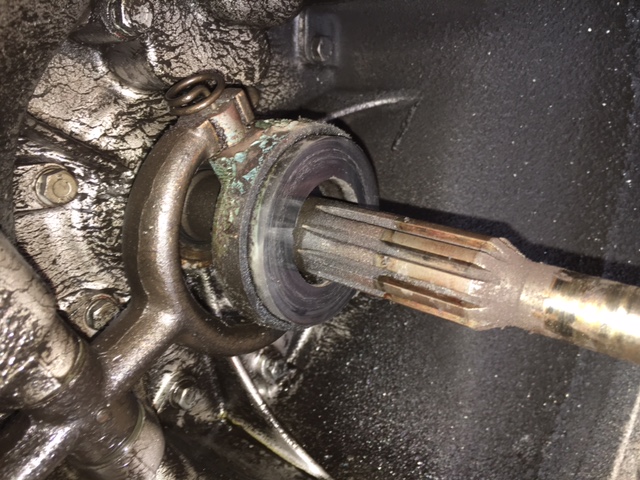

If the new ones aren't lasting, I have a decision to make: the bearing that's in there has about 110K miles on it and looks almost brand new, but usually I'd replace this on principle (photo below). Anyone have a new one laying around they can measure the depth of the (usable) graphite?

Sorry that this doesn't have any dimensions listed, but this is an extremely low mile t/o brng that was in my car while fitted with an MGC box (next to no miles, actually). There's not a lot of difference in the way they look.
I personally haven't heard any complaints about what's currently available, but if you're concerned about them, your existing t/o looks to have a whole 'nother lifetime of use left in it.

Bob, as it happens I DID record the thickness of the new release bearing from Moss when I replaced mine in March 2014. The new bearing carbon measured 10/32". The one I was replacing had 80,584 miles on it (installed September 1997) but still measured 9/32". I had the gearbox out to rebuild the overdrive and replaced the pilot bushing and release bearing as a matter of course, but I kept the used one to reinstall next time because of its excellent history.
