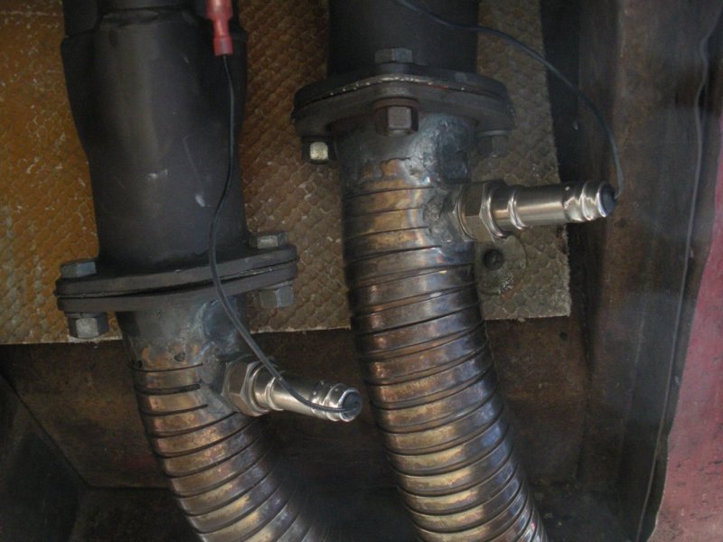

I have a K&N air/fuel meter switched between an O2 sensor in each downpipe. It was not cheaper than the two colortunes I also own. The setup's probably better than the colortunes as it allows you to see the mixture at speed and under load.

O2 sensors in downpipes, before any mixing.

Steve is right - you need real data to know what is going on and I started using an air/fuel monitor about 2001 but it took several years of still melting pistons and other problems before I did more research on air/fuel monitors and found that the inexpensive 1 wire meters are not very useful (sorry Steve). What you need is an analog wideband gage copy & paste this (I don't know how to do links :smile: https://www.jegs.com/i/AEM/017/30-5130/10002/-1 this is Jegs but Summit & Amazon & others sell them. They are not cheap but will tell you an actual number as opposed to the one wire gages that show a row of led lights and a general rich/lean. And as Steve says, you need two, one for each downtube.
I encourage all of you to do your own research - this will give you the data the rolling roads give you. It is also what modern fuel injected cars use for input into the computer engine management.
So, I went a step further in 2009 because I was tired of going lean at 5500-6000 and not being able to correct it so I bought two of the above wide band air/fuel ratio gages and also bought an aircraft EGT gage that is made for 6 cylinder aircraft engines so I could have a probe in each header branch to know the temps of each cylinder - model I bought is Aerospace Logic EGT-100-6P & I purchased it from Gulf Coast Avionics (was $575 in 2009). With this you have a choice of showing one cylinder, having it cycle thru them all at about 2-3 seconds on each, or have it constantly scan and show the hottest. So now I can not only monitor air/fuel but also what that does in terms of EGT. Saved me several melted pistons/distorted valves. I now generate most of what a rolling road does just with out HP & Torque info.
