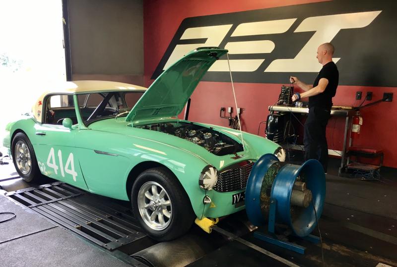

I do think wonder how available Rolling Road facilities are in the UK as I have not seen much of their presence in the US. I can see that adjusting a number of settings could be more effective when made in such a dynamic facility. However, the cost could be prohibitive.

do bear in mind that if you're still on original needles, the car may be weak and a rolling road is the safest bet. Otherwise, search for an SU needle chart and go for 10% richer through the range. It's what modern fuel needs.
