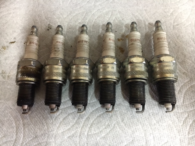

Here's my plugs after a warm shutdown after changing the oil; not proper methodology I know, but I had the plugs out for a compression test with 5,200 miles on rebuilt engine:
