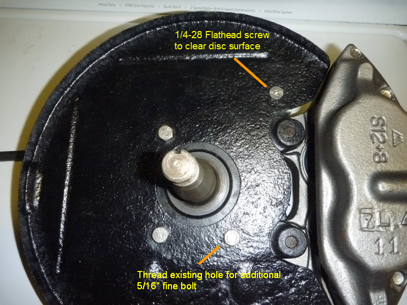

The factory found that without the dust shields the brakes wore faster. I have a BN4 (originally with drum brakes) that I converted to discs. The disc pads might wear out faster, but we drive so little per year, the rubber parts will expire due to time first. So, don’t worry about it.

Since my conversion is on a BN4, I would have to buy shields and would probably have to modify them.
To summarize: the best-handling (lightest) brake upgrade would be aluminum 4-piston calipers (AHspares, Wilwood) with the lighter pre-BJ8 3/8" rotors and no dust shields.
