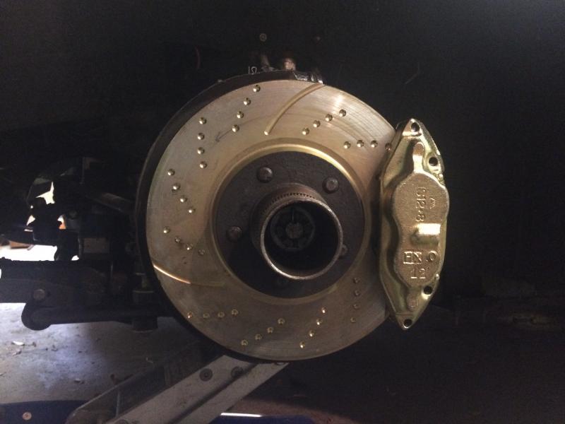

Ray,
I have a 345hp V8 with BJ7 brakes and I autox on occasion. Even the factory went to bigger pad area when they switched from Girling 14 calipers in the BJ7 to Girling 16 calipers in the BJ8. Although my brakes are adequate for street use, they could be better for autox. Using the Toyota calipers will allow me to use the vented/slotted discs from Moss that only fit BJ8 calipers that have a wider spacing between the pistons than the BJ7 calipers. The Toyota calipers have the same spacing.

Proof of concept:
Using the Denis Welch Racing caliper brackets with 3.5" spacing on the ears on the original BJ7 spindle will allow use of the Toyota 4-pot calipers and BJ8 slotted, vented discs.
Total price of the Moss BJ8 upgrade is $805, plus you would have to add $160 plus shipping for the DWR brackets.
I already had the drilled rotors {$190} and caliper brackets ($160) and bought the loaded Toyota calipers from Amazon - $180 , and $16 for the TR6 caliper mounting bolets - so saved a considerable amount over the Moss kit.
The installation isn't complete yet, I need to make up the hard brake line between the caliper and braided stainless line per Steve Gerow's instructions. It looks to me like British Car Specialists are now carrying the caliper brackets: https://www.britishcarspecialists.c...e/index.php?category=BRAKES&subcategory=FRONT and TS Imports carries steel braided lines from the calipers for the TR6 that look like they might work. https://www.tsimportedautomotive.com/tr250_tr6.html I haven't verified these parts, so check them out before you purchase.
