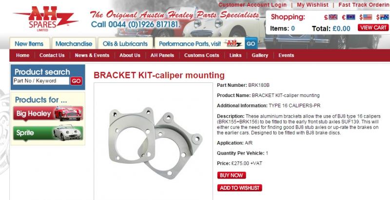

FWIW - AH Spares sells aluminum brackets which specifically allow the use of later 3.5" Type 16 brakes with late BJ8 1/2" rotors on the earlier stub axles.
This makes it possible to convert earlier cars to the Toyota 4-pot calipers, without sourcing the impossible-to-find BJ8 stub axles.
