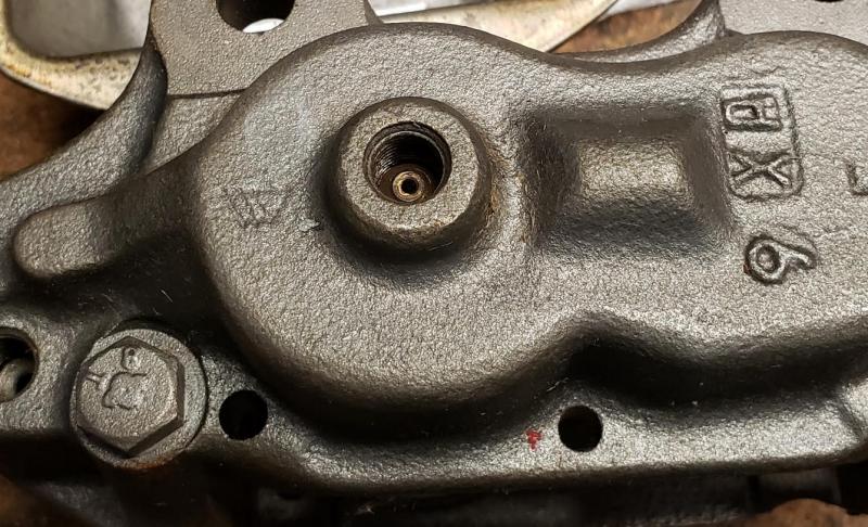

I already had Techna-Fit hoses going to my stock set up, so I'm making hard lines going to those hoses following your photos. I'll be interested whether I'll need to change the master cylinder as well. Time will tell. I still have the standard, non-boosted .625" MC. Couldn't your friend have Techna-Fit make up a set of hoses using a banjo fitting to the Toyo calipers?
A banjo-fitted hose would be a solution, but would require milling a sealing surface on the boss as well as a 10 mm x1.0 banjo bolt & sealing washers. Probably easier to source a hose from techna-fit like the one sold in the Moss kit.

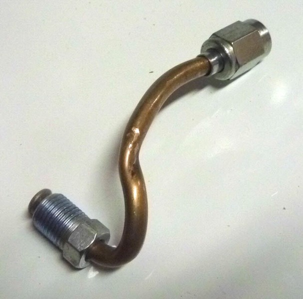

There are a lot of banjo hoses available for reasonable prices. If you were to remove the spring and take a vertical pic like below, you'd see if you have the clearance for a banjo hose.
I strongly advocate removing the spring and moving your suspension to full lock and bump to verify your hose or pipe doesn't hit the shock tower.

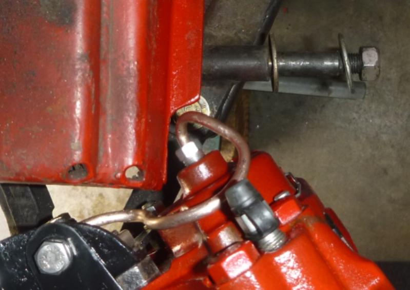

My second design pipe and tube nut would also hit the un-notched shock tower flange at full bump:
My first design - similar to Moss' kit - hit the tower backing out of my driveway onto the street:
