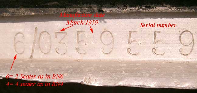

Does anybody know of any markings or how to tell what year these tops fit?

see attached pic for s/n info
